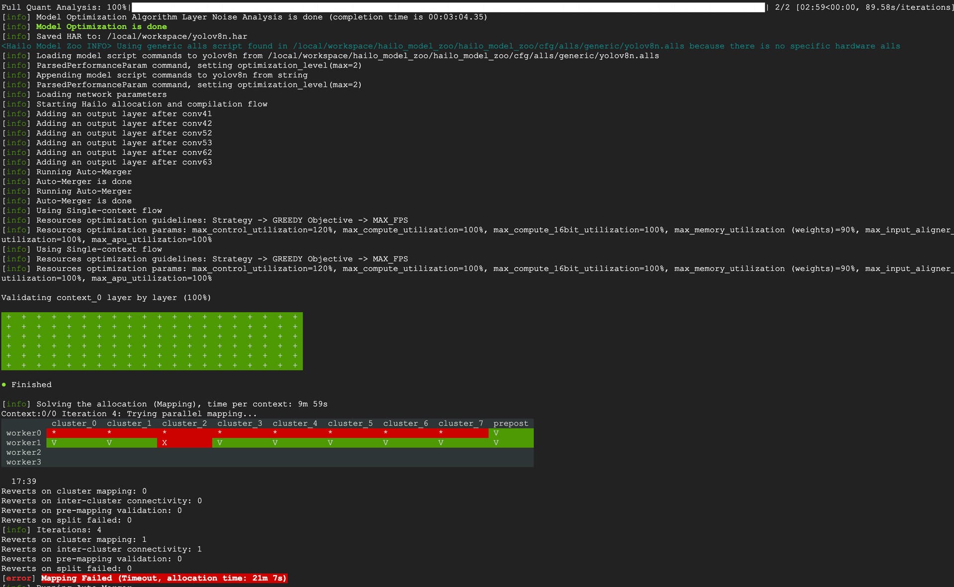

[info] Solving the allocation (Mapping), time per context: 9m 59s
Context:0/0 Iteration 0: Trying parallel splits...

Validating context_0 layer by layer (100%)
● Finishedcshortcut_conv4_to_conv5_postprocess
Context:0/0 Iteration 4: Trying parallel mapping...
          cluster_0  cluster_1  cluster_2  cluster_3  cluster_4  cluster_5  cluster_6  cluster_7  prepost
 worker0  *          *          *          *          *          *          *          *          V
 worker1  V          V          V          V          V          V          V          X          V
 worker2  *          *          *          *          *          *          *          *          V
 worker3
  18:03
Reverts on cluster mapping: 0
Reverts on inter-cluster connectivity: 0
Reverts on pre-mapping validation: 0
Reverts on split failed: 0
[info] Iterations: 4
Reverts on cluster mapping: 1
Reverts on inter-cluster connectivity: 1
Reverts on pre-mapping validation: 1
[error] Mapping Failed (Timeout, allocation time: 47m 29s)

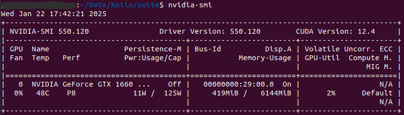

NVIDIA-SMI 565.77.01
Driver Version: 566.36
CUDA Version: 12.7
In the case of WSL2, is there any alternative besides downgrading the drivers on the Windows side?

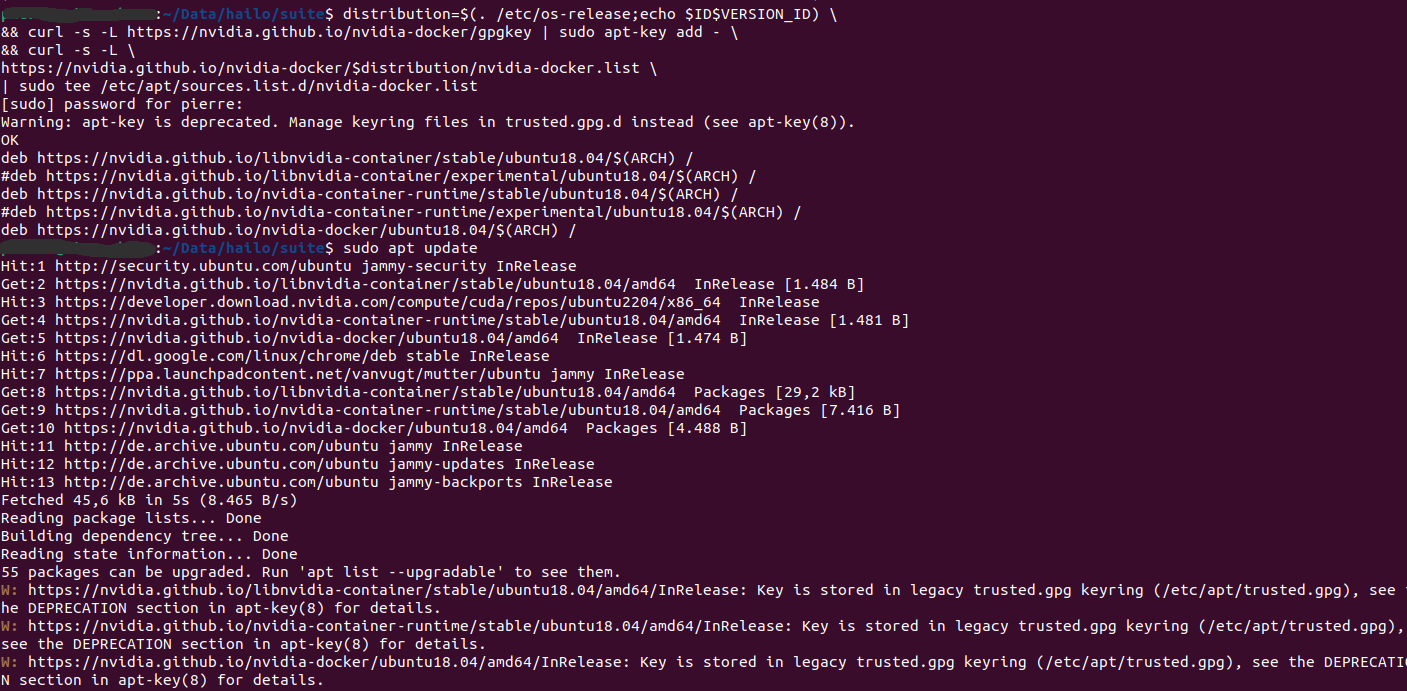

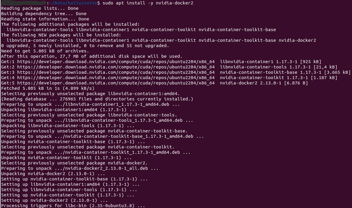

I replicated the main steps on an Ubuntu 22 machine, please check them and and look for possible mismatches.
  • First, I added my user to the docker group, logged out and logged back in.
    sudo usermod -aG docker ${USER}
  • Then, I looked for the driver version outside on my machine. The version is already greater than 525.0, so I sticked with it (despite 525.0 offers better compatibility, according to CUDA documentation)

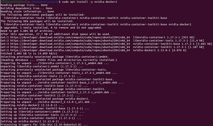

  • Installed nvidia-docker2, as per instructions:
    nvidia_docker2 restart docker
  • I ran the hailo_ai_sw_suite_docker_run.sh script to install the Hailo Docker:
    As you can see, the –gpus all argument was used in the container creation. This argument will be used ONLY if the GPU was successfully detected. In more details, the docker run scripts checks for the output of the following commands:
    lspci | grep "VGA compatible controller: NVIDIA"
    dpkg -l | grep 'nvidia-docker\|nvidia-container-toolkit'
    Please check if these commands give a non-empty output when you run them outside the docker, and also create a new container to verify the arguments passed to the docker run command.

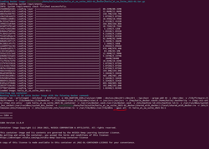

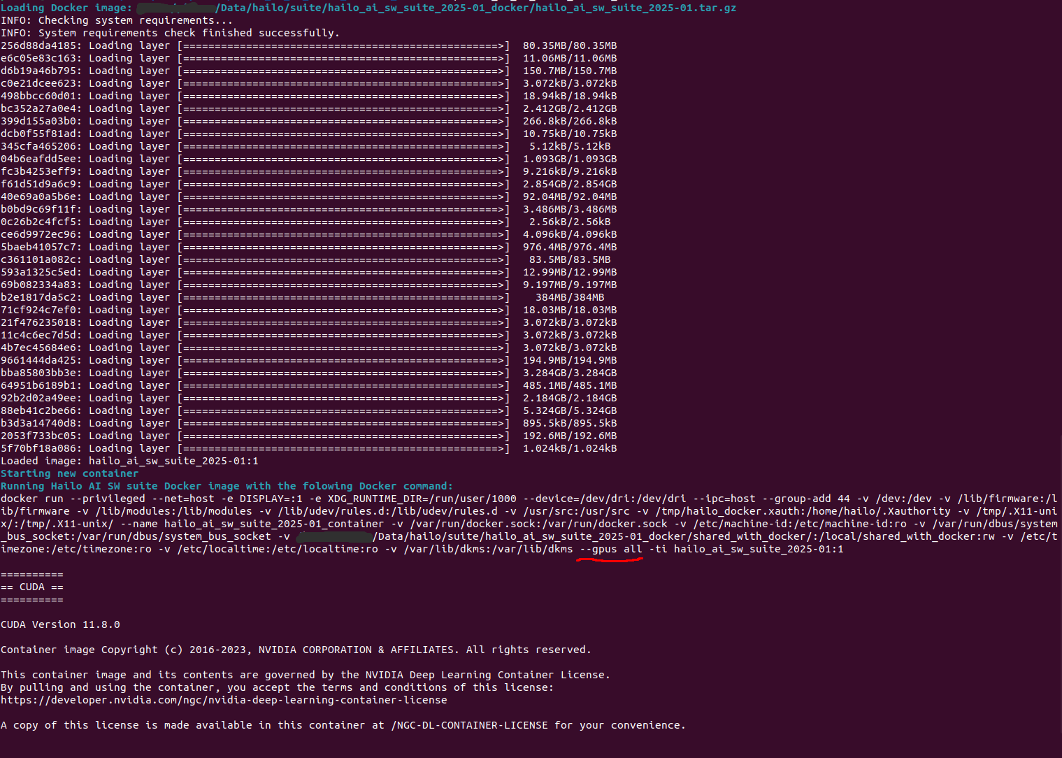

I ran the script and saw that docker is not running with the -gpus all flag.
Looks like that your code is not able to identify this PCI entry:
00:04.0 3D controller: NVIDIA Corporation TU104GL [Tesla T4] (rev a1)
I made a small change in the script to use the --gpus all flag regardless to the GPU verification.
looks like I’m able to use the GPU but got the following error:
This is the log that I’ve:
● Finished
 worker1  V          V          X          V          V          V          V          V          V
 worker2
 worker3
  17:39
[error] Mapping Failed (Timeout, allocation time: 21m 7s)
