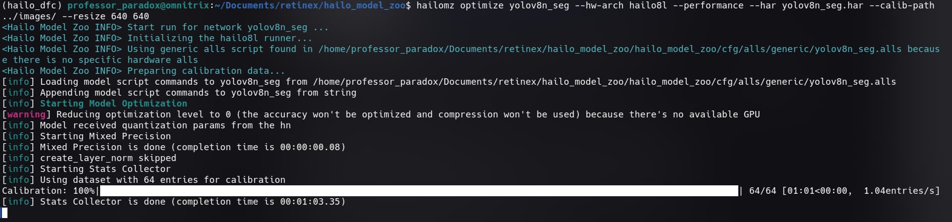

Hailomz not able to use GPU during optimization
I get this warning message when running hailomz optimize. How to make sure it is able to use GPU?

What is the GPU model that you have? Is that a supported type?
Its GTX 1650. Where can I check for supported models?
