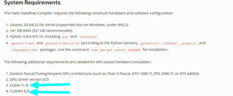

During the training i noticed that the compilation doesn’t utilize the GPU which i verified using the “nvidia-smi”. Any workaround to utilize the GPU?
[info] Starting Model Optimization
[warning] Reducing optimization level to 0 (the accuracy won't be optimized and compression won't be used) because there's less data than the recommended amount (1024), and there's no available GPU
Hi @ruslan, the compiler doesn’t make use of the GPU, only the quantizer\optimizer.
@ruslan not identifying the GPU is usually caused by incompatible CUDA versions.
You can find the DFC system requirements in its guide:
