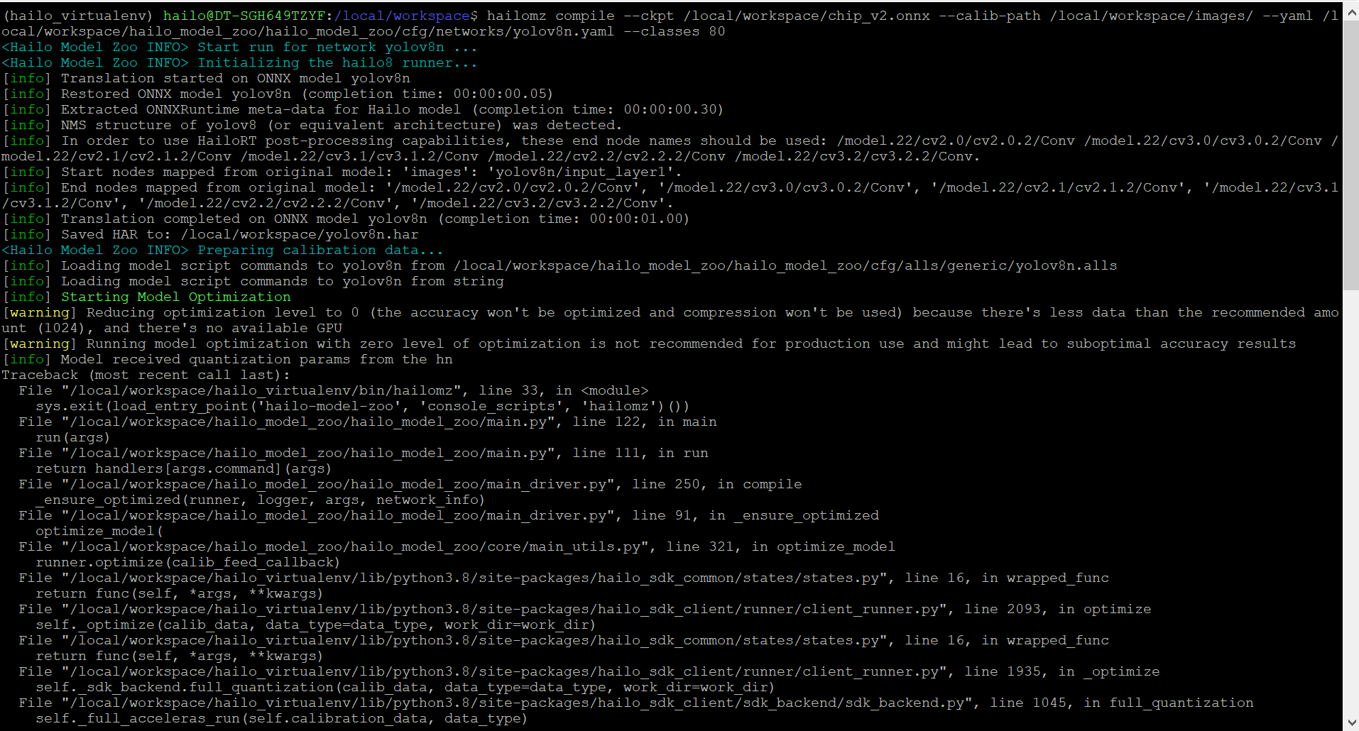

I encountered issue during the onnx to hef conversion

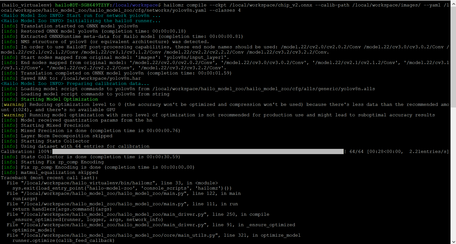

Command I executed inside the hailo software suite : hailomz compile --ckpt /local/workspace/chip_v2.onnx --calib-path /local/workspace/images/ --yaml /local/workspace/hailo_model_zoo/hailo_model_zoo/cfg/networks/yolov8n.yaml --start-node-names images --end-node-names /model.22/Sigmoid /model.22/dfl/Reshape_1 --classes 80
Error I faced :
Please help me here, Thanks in advance
Hi @bhaskarreddy,
Are the layer names in your model different from the ones in the pre-trained version of the model? If not, passing the -start-node-names and -end-node-names is unnecessary as it’s already part of the yaml file.

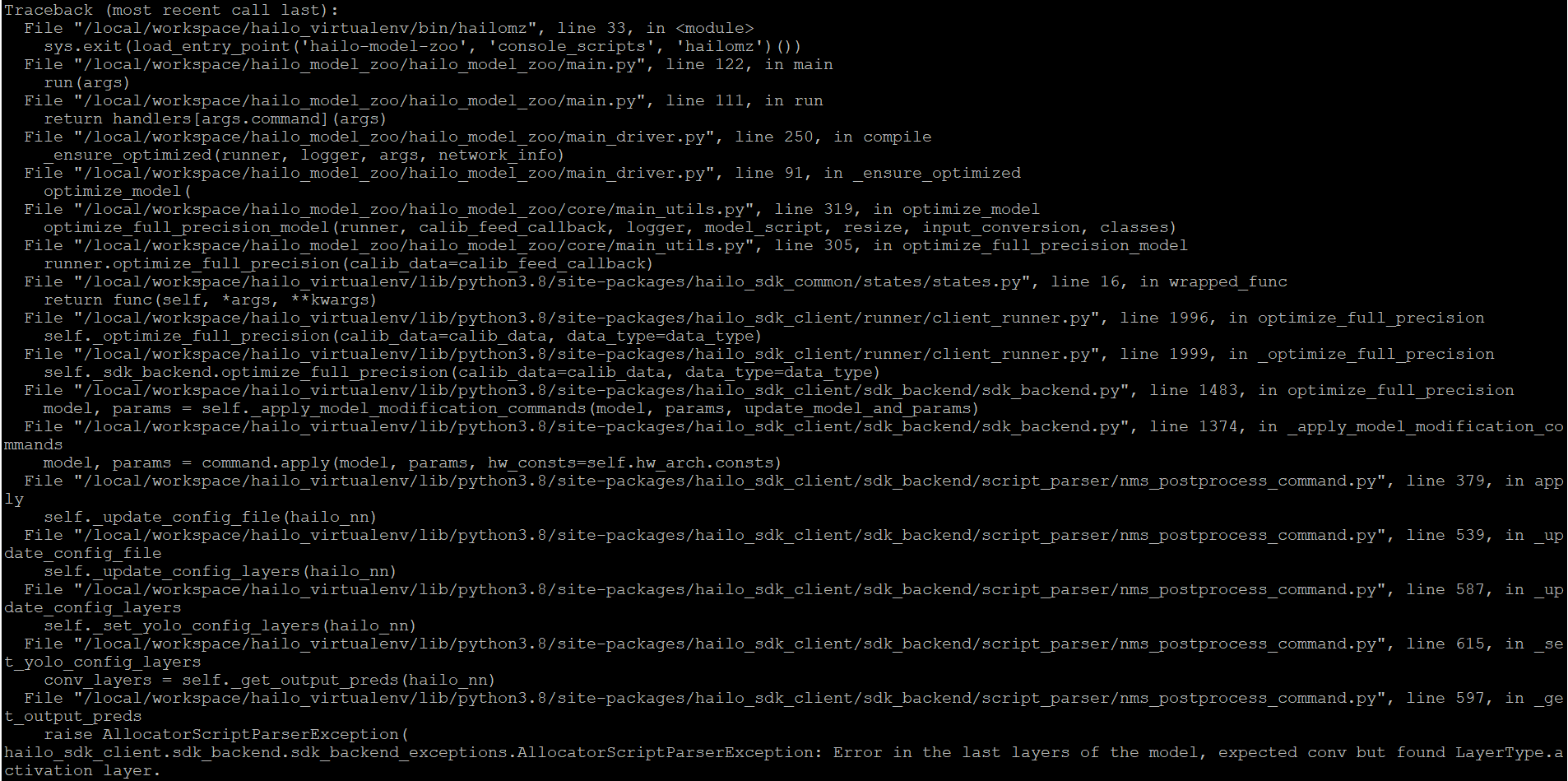

Hi @Marina_Vilela_Bento,

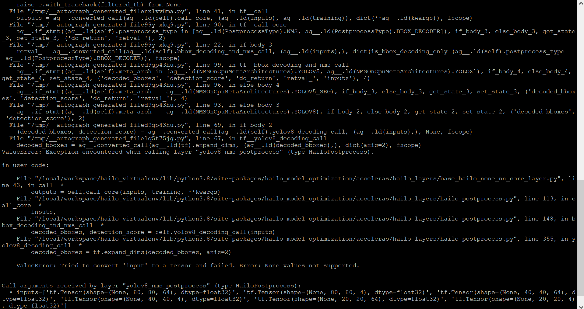

I tried to remove -start-node-names and -end-node-names from command.
Now, encountered with other issue.
@bhaskarreddy just to get a bit more info, chip_v2 is a re-trained yolov8n, right? How was it re-trained? Was it re-trained with 80 classes?

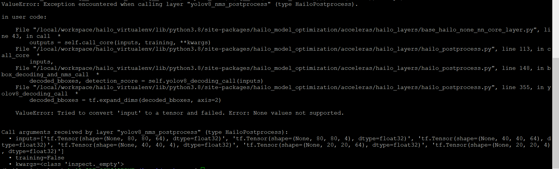

Sorry @Marina_Vilela_Bento , It was my bad. classes for my retrained model is 4.

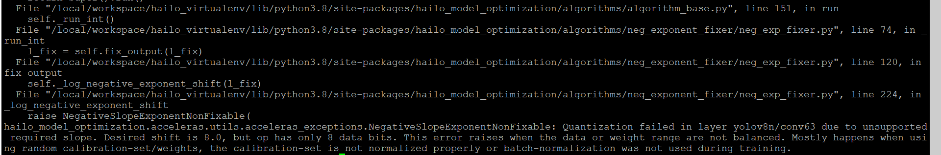

Now, When I gave 4 as number of classes I got below error.
Q: How was it re-trained?
A: chip_v2 was re-trained by using yolov8n, by using cli : yolo train data=data.yaml model=yolov8n.pt epochs=100 imgsz=640
Q: Was it re-trained with 80 classes?
A: 4
could you try this solution below?
It means adding quantization_param([conv42, conv53, conv63], force_range_out=[0.0, 1.0]) to this file:
Thanks a lot, It worked after adding quantization_param([conv42, conv53, conv63], force_range_out=[0.0, 1.0]) in hailo_model_zoo/hailo_model_zoo/cfg/alls/generic/yolov8n.alls

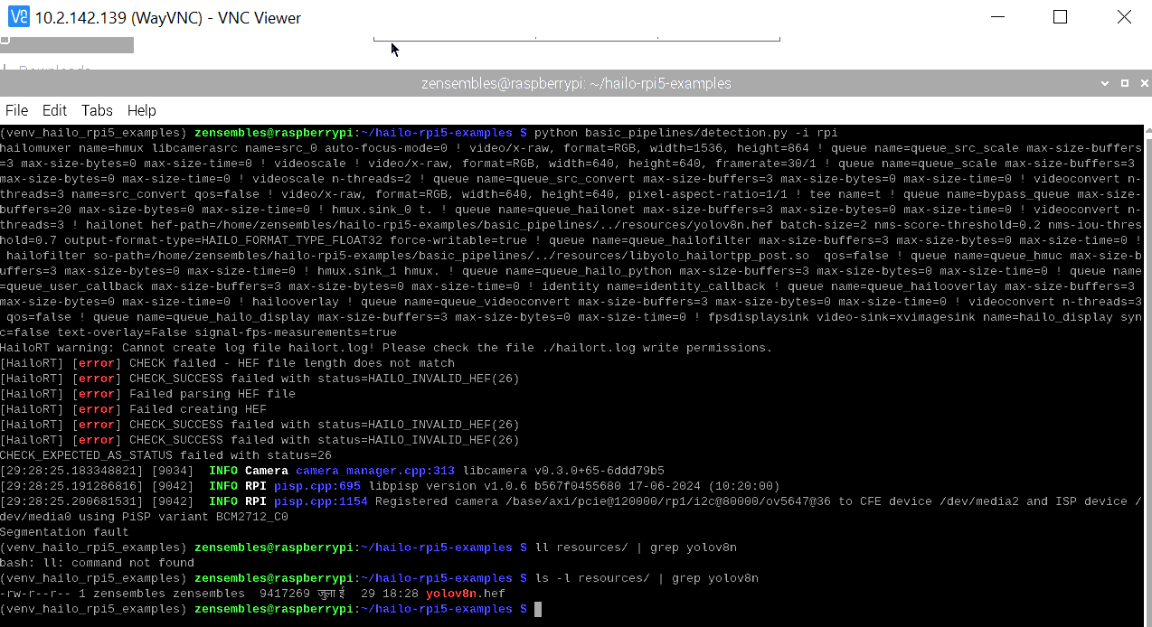

When, I’m using same hef in hailo-rpi5-examples/basic_pipelines/detection.py at main · hailo-ai/hailo-rpi5-examples · GitHub,
I encountered with this issue.
Can you please look into this.
this is due to a version mismatch between the DFC and the HailoRT, please check out the topic below:
You can either upgrade the HailoRT, or downgrade the DFC/MZ and re-compile the model.
@Marina_Vilela_Bento, After downgrading Hailo SW Suit to hailo_ai_sw_suite_2024-04_docker, I’m able to compile hef in rpi5-examples.

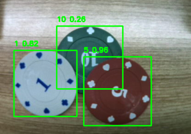

But during dectection I have some problem, like In my dataset, I have only four labels i.e (1, 5, 10 and 25).
But It is detecting as motorcycle, bicycle.
Expected is it should detect 1, 5, 10, 25.
But using same model as pt, In my local it is detect properly.
But when I use same with hef, It is detecting as motor cycle and bicycle.
Am I doing anything wrong?
Nice!
It seems like everything is working well, the only issue seems with the labels file. In the detection example from hailo-rpi5-examples, there’s a --labels-json flag which you can use to configure the labels that will be drawn on the image.
I see now that there’s also a mixup that 1, 10 and 25 are the same class. This could be due to the quantization noise. You can try using a larger calibset and more advanced post-quant algorithms. You can read about it here.

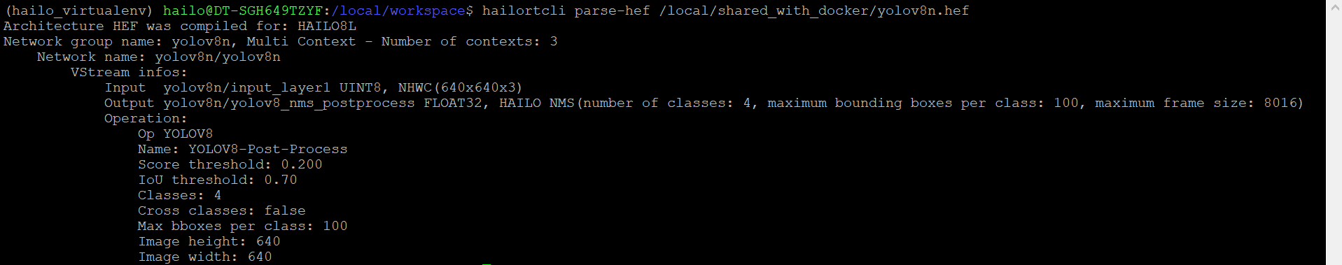

I’m using dataset with 5176 images, I’m using Hailo SW Suite for hef conversion.
And using cli to convert to hef file. How can I Use advance post-quant algorithms
cli command I used for hef conversion: hailomz compile --ckpt /local/shared_with_docker/5k_chips.onnx --calib-path /local/shared_with_docker/5k_chips/images/ --yaml /local/workspace/hailo_model_zoo/hailo_model_zoo/cfg/networks/yolov8n.yaml --classes 4 --hw-arch hailo8l
You can choose the post-quant algorithms with commands passed in the model script.
For yolov8n, the model script is located here.
You can try finetuning or adaround for example. You can read more about post-quant optimization commands here.
