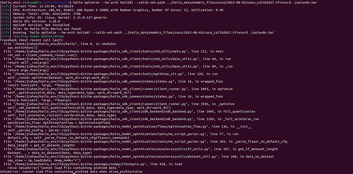

so I input command hailomz parse yolov8n
and I get yolov8n.har
, and then I input hailomz optimize yolov8n --har /PATH/yolov8n.har
, and I get error below:
(hailo_env) jiahao@PC:~/Downloads$ hailomz optimize yolov8n --har /home/jiahao/Downloads/yolov8n.har --hw-arch hailo8l
<Hailo Model Zoo INFO> Start run for network yolov8n ...
<Hailo Model Zoo INFO> Initializing the hailo8l runner...
[warning] hw_arch from HAR is hailo8 but client runner was initialized with hailo8l. Using hailo8l
File "/home/jiahao/hailo_env/bin/hailomz", line 8, in <module>
sys.exit(main())
File "/home/jiahao/hailo_env/lib/python3.8/site-packages/hailo_model_zoo/main.py", line 122, in main
run(args)
File "/home/jiahao/hailo_env/lib/python3.8/site-packages/hailo_model_zoo/main.py", line 111, in run
File "/home/jiahao/hailo_env/lib/python3.8/site-packages/hailo_model_zoo/main_driver.py", line 220, in optimize
model_script = _extract_model_script_path(
File "/home/jiahao/hailo_env/lib/python3.8/site-packages/hailo_model_zoo/main_driver.py", line 55, in _extract_model_script_path
else resolve_alls_path(networks_alls_script, hw_arch=hw_arch, performance=performance)
File "/home/jiahao/hailo_env/lib/python3.8/site-packages/hailo_model_zoo/core/main_utils.py", line 38, in resolve_alls_path
return path_resolver.resolve_alls_path(Path(hw_arch) / Path("base" if not performance else "performance") / path)
File "/home/jiahao/hailo_env/lib/python3.8/site-packages/hailo_model_zoo/utils/path_resolver.py", line 29, in resolve_alls_path
raise FileNotFoundError("no alls found for requested hw_arch")
FileNotFoundError: no alls found for requested hw_arch
