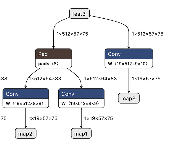

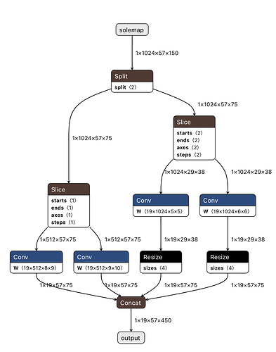

I’m trying to convert a small model from ONNX to HEF to run on hailo8.
This model has 1 input (float32[ 1, 1024, 57, 150] ) and 1 output (float32[ 1, 19, 57, 450]).
This is the graph of the ONNX model:
