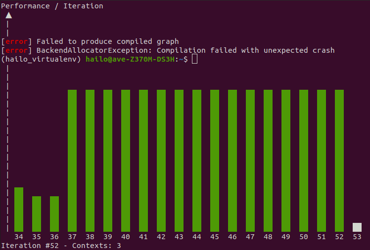

The image above shows the terminal window when the error occurs.
Also, I’m curious if there’s a parameter that allows for early termination of the iterations, as seen in the image above.
Thank you!

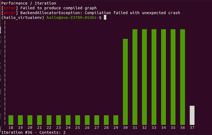

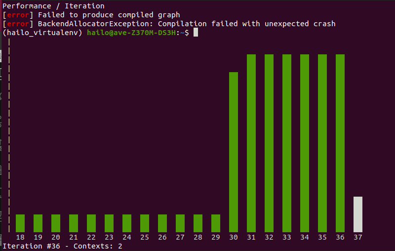

After moving to a computer with a better CPU and more memory, I’m now encountering a slightly different error. Could you suggest possible ways to fix the error shown in the image?

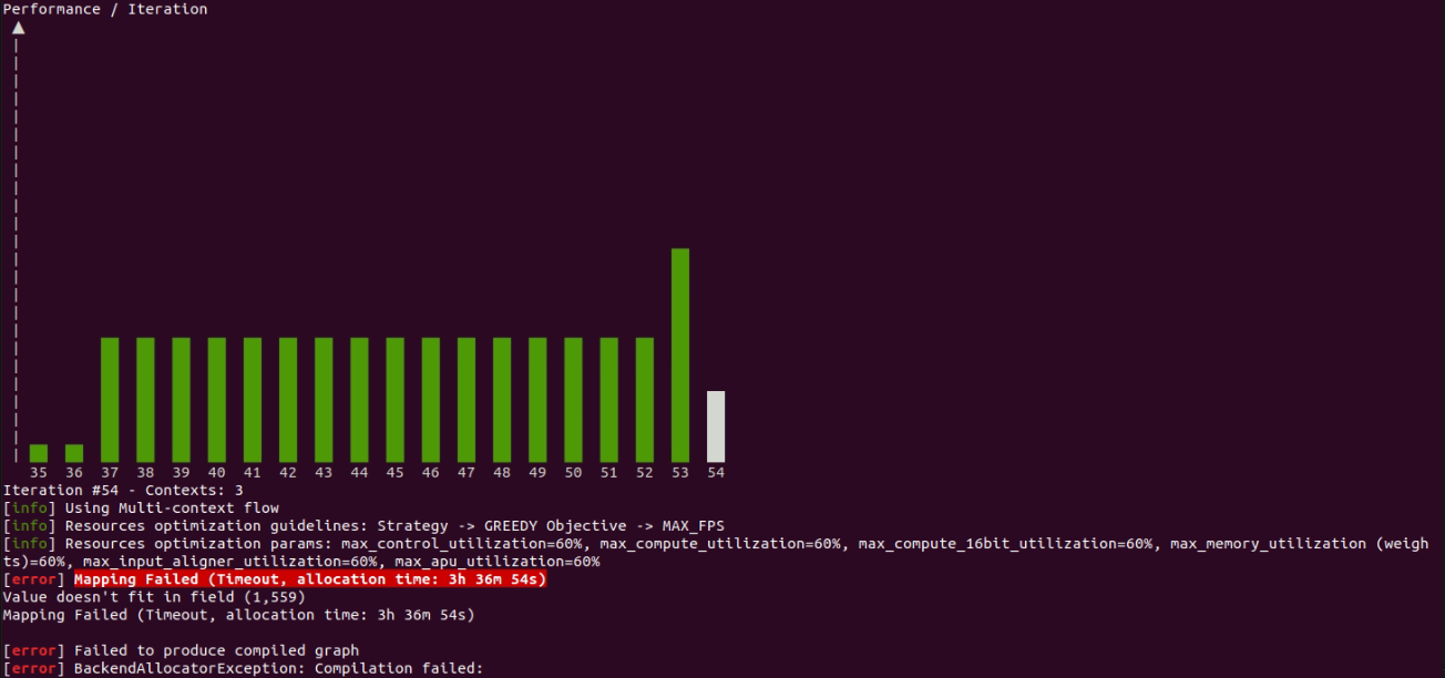

As you suggested, I modified the model script and executed it.
However, the same error still occurs.
I have tried adjusting various parameters, but the same error persists.
Please help me…
Do you maybe have a layer with a huge number of parameters?
