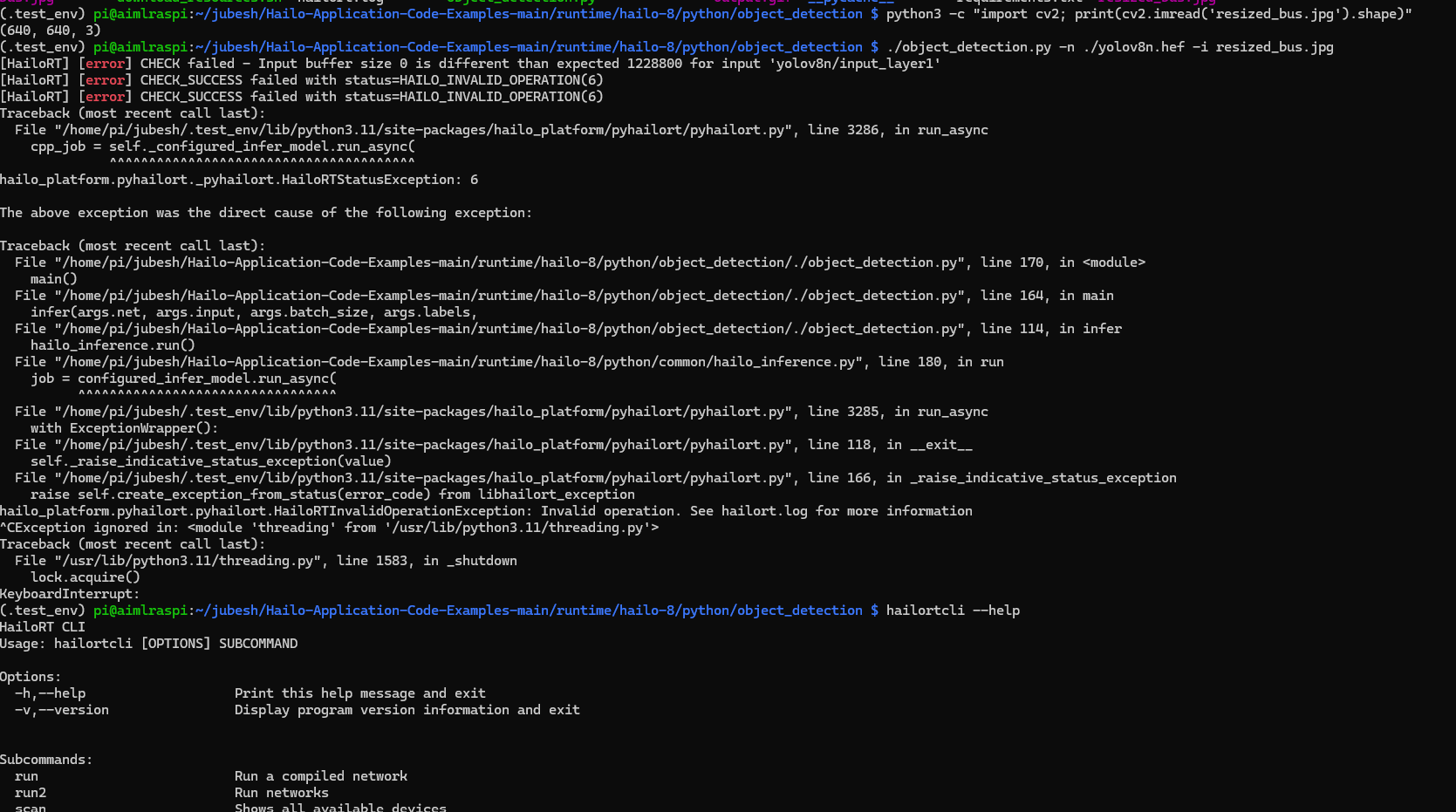

This is the guide i was following in order to run the object detection model into Hailo8 target.
Hailo Application Code Examples
But idk why it shows this error.
Hi, try to downgrade numpy library to version 1.23.2. It is probably above 2 right now.
Thanks a lot sir.
It finally worked.
Happy to hear that, had the same problem. Good luck ![]()
