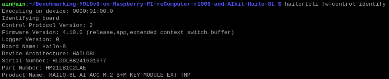

And I know the hailort, hailodriver and tapps is not suitable with my hef model. So I update hailort and hailodriver, and here is the result:
