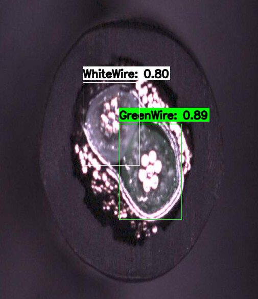

Thank you guys very much. I got everything up and running and now am a proud owner of my custom YOLOv8 inference running on a Hailo8 :slight_smile:
PS: here is the proof
