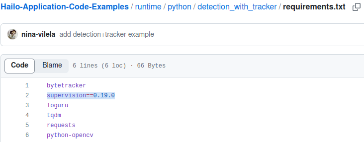

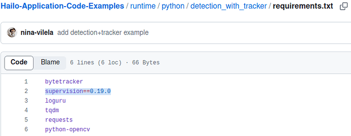

@omria thanks for the sample codes, I believe this what I need.
However I ran into a version issue. In the “requirement.txt”, it states that the package supervision == 0.19.0 is required:
During installation, the system shows that it requires pillow >= 9.4 to install supervision 0.19.0, and I am needed to upgrade pillow version:
However, after the upgrade, Hailo Model Zoo crashed because it requires pillow <= 9.2.0:
Isnt’t it a contradiction of versions?
But anyway, I downgrade the pillow back to 9.2.0 and everything seems working.
Hi @ShingHin.Hung,
To avoid compatibility issues, it’s best to leave the DFC/MZ venv for their tools. So once you have a compiled model, you can use the hef on a separate venv for the inference.
