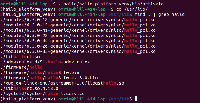

Could you try running the command from outside the virtual environment?
The expected output should look similar to this:
If you can’t find this output, it likely indicates that something in the driver installation failed or was removed. In this case, you’ll need to reinstall the driver first, and then reinstall HailoRT.
