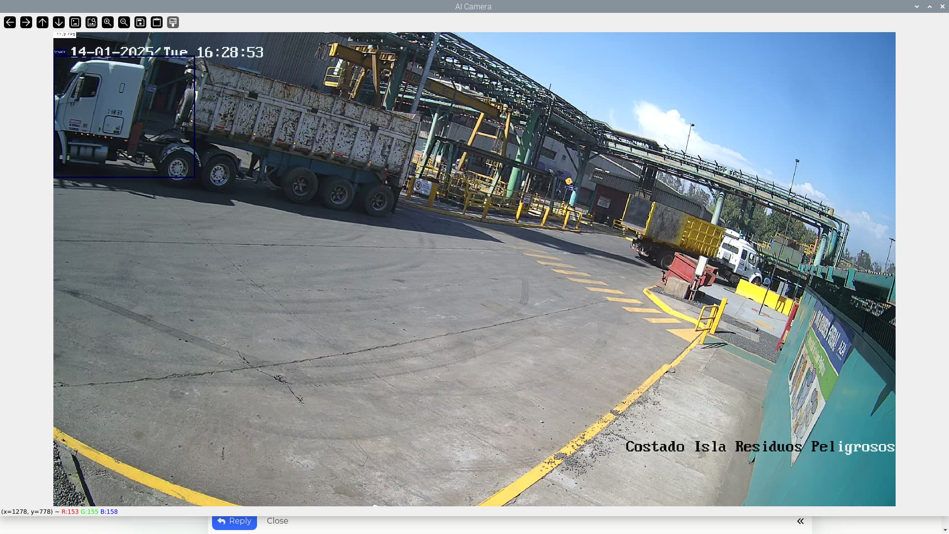

I have been able to run most of the examples (hailo_examples/examples at main · DeGirum/hailo_examples · GitHub). However, I have encountered issues when executing multithreading. I am currently using a Hailo 8l and would like to know if you have conducted tests with this chip. I see that in this particular example, models for Hailo 8 are used.
I have also experienced considerable decreases in inference speed when using RTSP cameras. I believe it is due to the size and quality of the video. Is it possible to modify the input size to the model to improve performance?
HI @claudio.veas
Glad to hear you were able to run most of the examples. Please let us know what kind of issues you are encountering when using multithreading and we will investigate further.
Regarding RTSP cameras: from the image you shared, it appears that the input resolution to the model is full HD (1920x1080). If the model is using input resolution of 640x640, then it is resized before going to the model. This operation is compute intensive and when executed on CPU, it can lead to lower FPS. One way to deal with this is to configure RTSP stream to a lower resolution. Typically, RTSP cameras allow multiple streams: main stream that is usually for recording and sub stream that can be configured to lower resolution (say 720p, 1280x720) and can be used for AI inference. Hope this helps.
