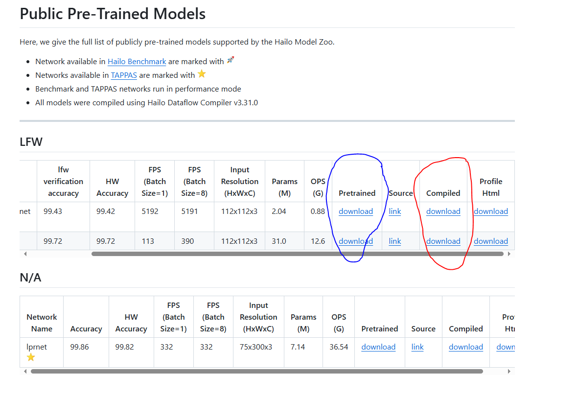

Thanks for that
When i downloading the links that i am getting it was there in the onnx format,But i need hef right to run in the my setup.
Or Help me out is there any way that i can convert the onnx into hef
Hi @Dendukuri_Narendra_v
In github tables you probably are not seeing all the columns. Please scroll to the right so that you will find links to precompiled models.
FYI: If you use our PySDK and the cloud zoo, the models will be downloaded automatically.
