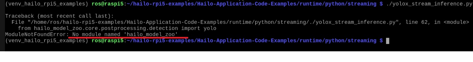

When I run Hailo-Application-Code-Examples/runtime/python/streaming at main · hailo-ai/Hailo-Application-Code-Examples · GitHub,
The script will call Hailo model zoo but Raspi5 can’t install DFC then it also can’t install Hailo model zoo. Have you successfully run this on a Raspberry Pi 5?

Hi Klausk sir,
Thanks for your help. I have followed your instruction to download model from git hub but When I run the “/Hailo-Application-Code-Examples/runtime/python/streaming/yolox_stream_inference.py”. it is same error as photo
facing same issue…any solution?

Hi
we cannot install hailo_model_zoo in rpi…so how to test the examples from Hailo-Application-Code-Examples in rpi ?

    if arch == 'fast':
        meta_arch = 'fast_sam'
        kwargs['score_threshold'] = 0.25
        kwargs['nms_iou_thresh'] = 0.7
        kwargs['meta_arch'] = 'yolov8_seg_postprocess'
        num_of_classes = '1'
        kwargs['classes'] = 1
else:
    error = 'Not a valid architecture. Please choose an architecture from the this list: v5, v8, fast'
    raise ValueError(error)
kwargs['classes'] = int(num_of_classes)
output_dir = args.output_dir
if not output_dir:
    output_dir = 'output_images'
devices = Device.scan()
hef = HEF(args.hef)
inputs = hef.get_input_vstream_infos()
outputs = hef.get_output_vstream_infos()
with VDevice(device_ids=devices) as target:
    configure_params = ConfigureParams.create_from_hef(hef, interface=HailoStreamInterface.PCIe)
    network_group = target.configure(hef, configure_params)[0]
    network_group_params = network_group.create_params()
    [log.info('Input  layer: {} {}'.format(layer_info.name, layer_info.shape)) for layer_info in inputs]
    [log.info('Output layer: {} {}'.format(layer_info.name, layer_info.shape)) for layer_info in outputs]
    height, width, _ = hef.get_input_vstream_infos()[0].shape
    kwargs['img_dims'] = (height,width)
    input_vstream_info = hef.get_input_vstream_infos()[0]
    input_vstreams_params = InputVStreamParams.make_from_network_group(network_group, quantized=False, format_type=FormatType.FLOAT32)
    output_vstreams_params = OutputVStreamParams.make_from_network_group(network_group, quantized=False, format_type=FormatType.FLOAT32)
    with InferVStreams(network_group, input_vstreams_params, output_vstreams_params) as infer_pipeline:
        for i, image in enumerate(images):
            processed_image = preproc(image, height=height, width=width)
            input_data = {input_vstream_info.name: np.expand_dims(processed_image, axis=0).astype(np.float32)}
            with network_group.activate(network_group_params):
                raw_detections = infer_pipeline.infer(input_data)
                results = func_dict[meta_arch](raw_detections)[0]
                output_path = os.path.join(os.path.realpath('.'), 'output_images')
                if not os.path.isdir(output_path):
                    os.mkdir(output_path)
                processed_img = Image.fromarray(visualize_yolov5_seg_results(results, np.expand_dims(np.array(processed_image), axis=0), score_thres=0.3, class_names=num_of_classes, **kwargs))
                processed_img.save(f'{output_dir}/output_image{i}.jpg', 'JPEG')
type or paste code here
Had to copy this to the folder where i had my code :cython_utils
refer :from cython_utils.cython_nms import nms as cnms
