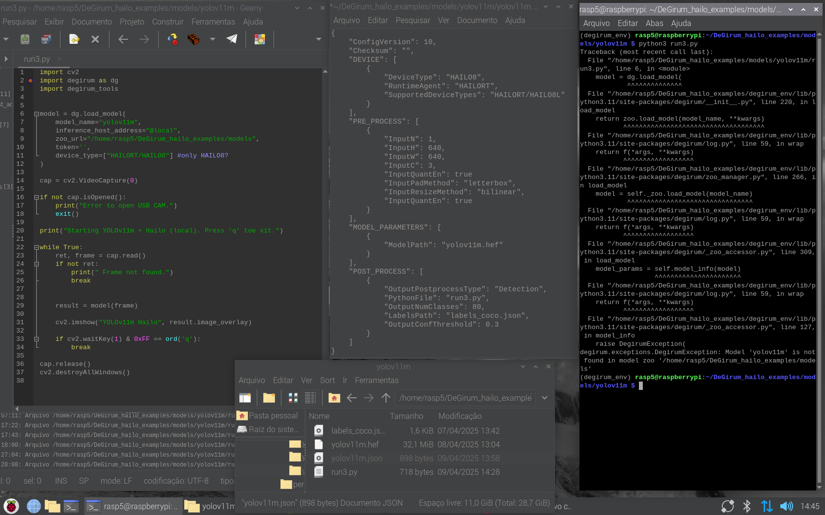

I have a directory /home/rasp5/DeGirum_hailo_examples/models. Inside, I have a folder “yolov8n_relu6_coco–640x640_quant_hailort_hailo8_1” similar to the one shown in guide 1. In this same folder, I created a new one named “yolov11m” which contains the yolov11m.hef template, yolov11m.json and “labels_yolov8n_relu6_coco.json” (yes, I’m using the same labels file as in the example).
My yolov11m.json is as follows:
    “ConfigVersion": 10,
    “Checksum": ‘40a9f567771ad5a76a36c6383662cc477247b973a453d0ded0a0d5689b43b488’,
    “DEVICE": [
            “DeviceType": ‘HAILO8’,
            “RuntimeAgent": ‘HAILORT’,
            “SupportedDeviceTypes": ”HAILO8”
    “PRE_PROCESS": [
            “InputN": 1,
            “InputH": 640,
            “InputW": 640,
            “InputC": 3,
            “InputQuantEn": true
    “MODEL_PARAMETERS": [
            “ModelPath": ”yolov11m.hef”
    “POST_PROCESS": [
            “OutputPostprocessType": ‘’,
            “OutputNumClasses": 80,
            “LabelsPath": ”labels_yolov8n_relu6_coco.json”
My python code is:
import cv2

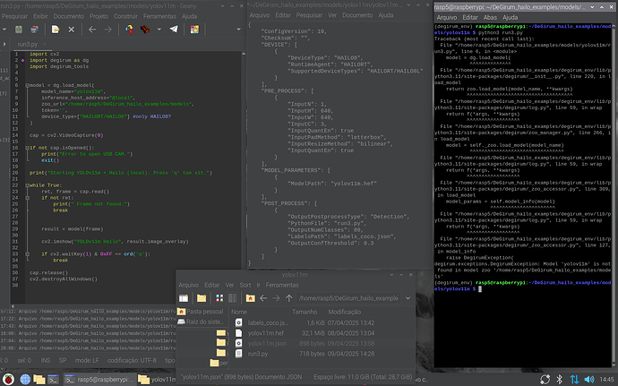

I think I’m having problems with the .json in the “POST_PROCESS” “OutputPostprocessType”: ‘’ part. I know that in the example model with yolov8n the field uses the description “DetectionYoloV8”. In this case, if I use DetectionYoloV8 or leave it empty(“”), I get an error, and if I use “None”, my code opens the window to transmit the video in real time, but without the post-processing of bounding boxes and object reckon…
When i exectute my py script (with OutputPostprocessType = "’ or “DetectionYoloV8”), my terminal returns:
(degirum_env) rasp5@raspberrypi:~ $ python3 run3.py
  File "/home/rasp5/run3.py", line 6, in <module>
    model = dg.load_model(
  File "/home/rasp5/DeGirum_hailo_examples/degirum_env/lib/python3.11/site-packages/degirum/__init__.py", line 220, in load_model
    return zoo.load_model(model_name, **kwargs)
  File "/home/rasp5/DeGirum_hailo_examples/degirum_env/lib/python3.11/site-packages/degirum/log.py", line 59, in wrap
    return f(*args, **kwargs)
  File "/home/rasp5/DeGirum_hailo_examples/degirum_env/lib/python3.11/site-packages/degirum/zoo_manager.py", line 266, in load_model
    model = self._zoo.load_model(model_name)
  File "/home/rasp5/DeGirum_hailo_examples/degirum_env/lib/python3.11/site-packages/degirum/_zoo_accessor.py", line 312, in load_model
    supported_device_types = self._model_supported_device_types(model_params)
  File "/home/rasp5/DeGirum_hailo_examples/degirum_env/lib/python3.11/site-packages/degirum/_zoo_accessor.py", line 176, in _model_supported_device_types
    ret = [
  File "/home/rasp5/DeGirum_hailo_examples/degirum_env/lib/python3.11/site-packages/degirum/_zoo_accessor.py", line 179, in <listcomp>
    if check_runtime_device_supported(
  File "/home/rasp5/DeGirum_hailo_examples/degirum_env/lib/python3.11/site-packages/degirum/_filter_models.py", line 51, in check_runtime_device_supported
    raise DegirumException(
degirum.exceptions.DegirumException: Invalid format of supported device list 'HAILO8' for model '/home/rasp5/DeGirum_hailo_examples/models/yolov11m/yolov11m.hef'
Do you have any suggestions as to what I can do to try to get my model to run? The OutputPostprocessType have some specific config to run yolo11 models?
I checked the support you give to other users in the following thread (User Guide 3: Simplifying Object Detection on a Hailo Device Using DeGirum PySDK - #48 by Loi_Tran). I’ve made some updates to my documents. I now have the following patch /home/rasp5/DeGirum_hailo_examples/models/yolov11m. Inside it, I have:
  • labels_coco.json (i changed the name, but is the same label as ’ labels_yolov8n_relu6_coco.json ')
  • yolov11m.hef
  • yolov11m.json :
    "ConfigVersion": 10,
    "Checksum": "69420",
    "DEVICE": [
            "DeviceType": "HAILO8",
            "RuntimeAgent": "HAILORT",
            "SupportedDeviceTypes": "HAILORT/HAILO8L"
    "PRE_PROCESS": [
            "InputN": 1,
            "InputH": 640,
            "InputW": 640,
            "InputC": 3,
            "InputQuantEn": true
            "InputPadMethod": "letterbox",
            "InputResizeMethod": "bilinear",
    "MODEL_PARAMETERS": [
            "ModelPath": "yolov11m.hef"
    "POST_PROCESS": [
            "OutputPostprocessType": "Detection",
            "PythonFile": "run3.py",
            "OutputNumClasses": 80,
            "LabelsPath": "labels_coco.json",
            "OutputConfThreshold": 0.3
  • run3.py :

Hi @Luiz_Mageste
where did you get the yolo11m.hef from?
“yolov11m” at , hailo_model_zoo/docs/public_models/HAILO8/HAILO8_object_detection.rst at master · hailo-ai/hailo_model_zoo · GitHub

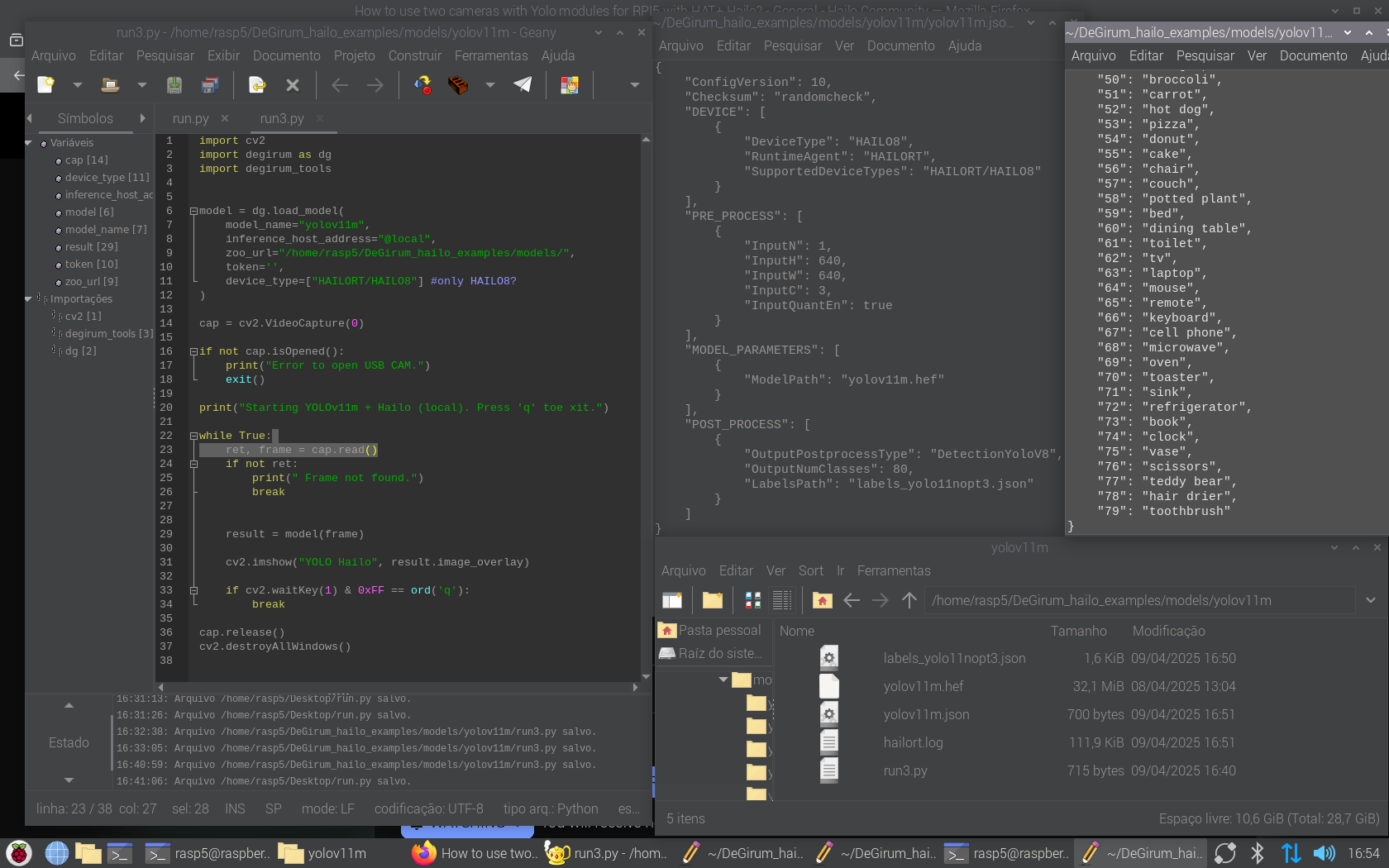

here’s a screenshot of my current screen:

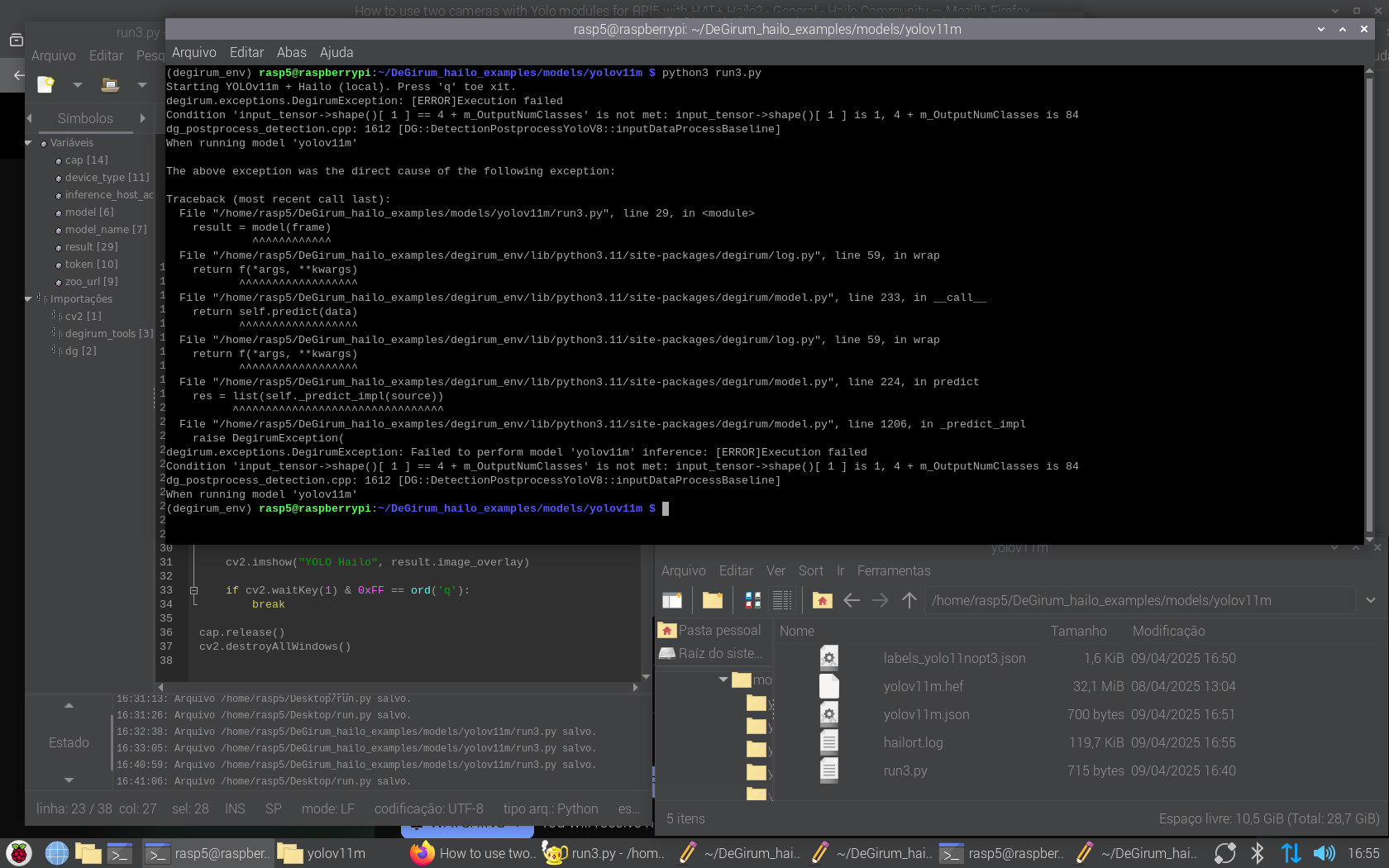

@shashi , new update… still with error:
I did a similar test with a direct download from DeGirum AI Hub, model “yolo11s_silu_coco–640x640_quant_hailort_hailo8_1”. The model worked perfectly. I then tried to base the same settings on my model above “yolov11m”, changing only the fields such as “model_name=” in the python script and “ModelPath” in the .json. as you can see in the images above, but that was not a sucess…
@Luiz_Mageste
Since the model is from hailo model zoo, you need a python postprocessor file. Please see User Guide 3: Simplifying Object Detection on a Hailo Device Using DeGirum PySDK
