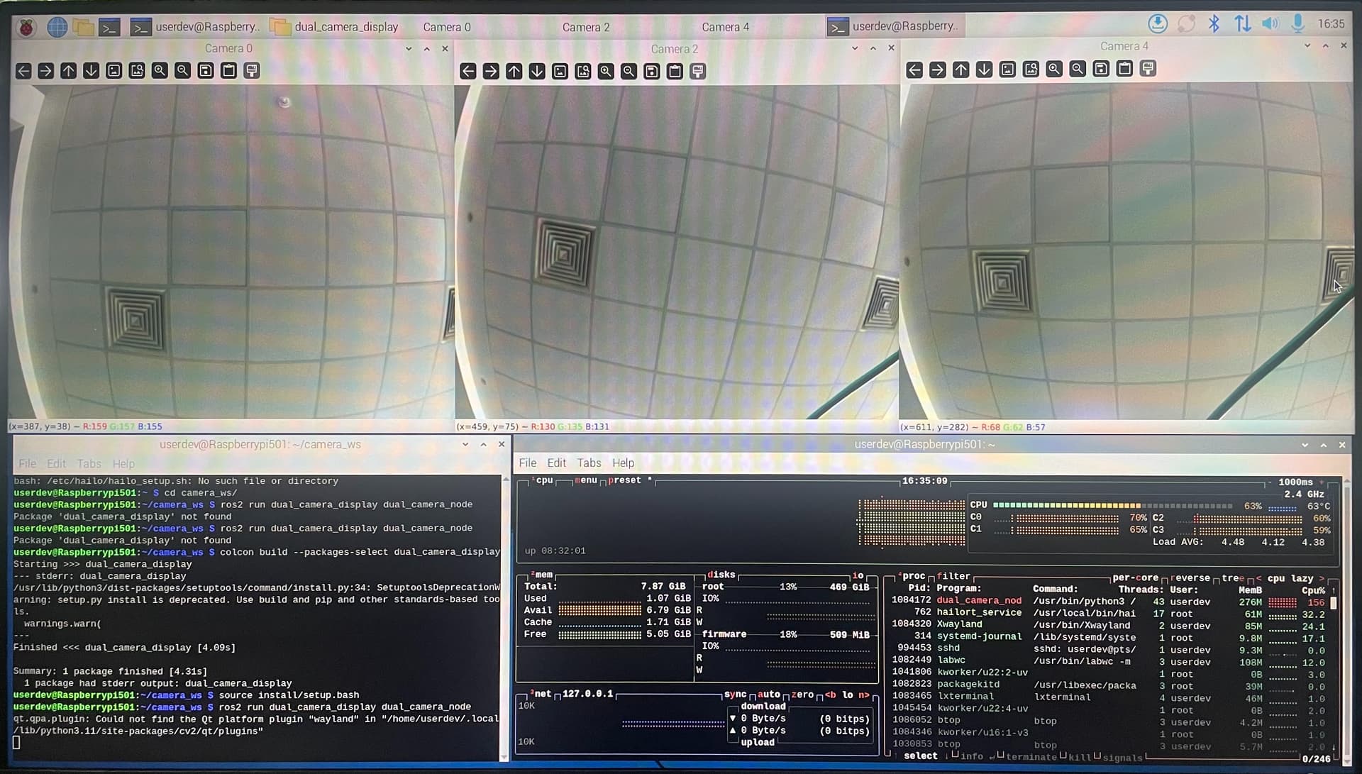

I’m currently running 3 cameras and 3 AI models using the DeGirum PySDK, and everything is working fine. Now I plan to scale up to 5 cameras, but I want to reduce CPU usage. Do you have any suggestions for optimization or performance improvements?
Below is 3 camera and cpu when running.

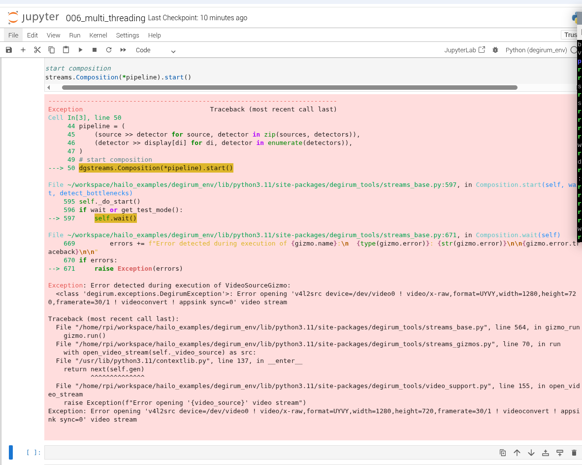

I modified the source
"    },\n",
     "    {\n",
     "        \"model_name\": \"yolov8n_relu6_face--640x640_quant_hailort_multidevice_1\",\n",
-    "        \"source\": 0,  # Webcam index\n",
+    "        \"source\": \"v4l2src device=/dev/video0 ! video/x-raw,format=UYVY,width=1280,height=720,framerate=30/1 ! videoconvert ! appsink sync=0\",  # Webcam index\n",
     "        \"display_name\": \"Webcam Feed\",\n",
     "    },\n",
     "]\n",

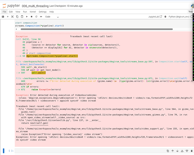

I use 006 example. And I have test our camera in gstreamer. But I got Exception.
Does it support openCV?

Hi @bernie_chen
The source as a gstreamer string is not natively supported yet in our degirum_toolsand we are currently working on it. In the meantime, we will provide you a way to define the source as a generator outside and pass it to the predict function. @Darshil_Modi will help you.
