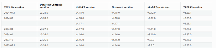

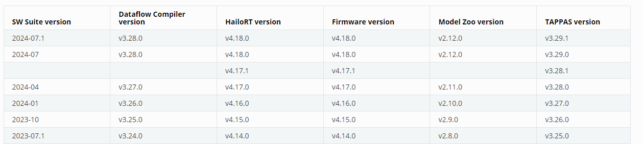

How Can I check the version compatibility between DFC and HailoRT?
Hey @anon17881598,
The DFC version 3.28 is compatible with HailoRT version 4.18, while DFC version 3.27 works with HailoRT version 4.17.
If you have these versions installed, you can check them by running the command hailo --version, which will display the currently installed versions of HailoRT and DFC.
@omria
Thanks for the answer.
I’m using DFC 3.27 for compile and HailoRT 4.18 for inference.
Are these versions compatible? In my environment, I have independent versions of DFC and HailoRT environments.
Hi @anon17881598,
If you’ll check in the developer-zone, documentation for the SW suite you’ll find this table to compatability:
