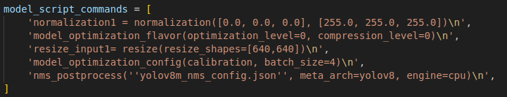

It is a custom trained single class detection yolov8m model. The following is the alls lines I used:
