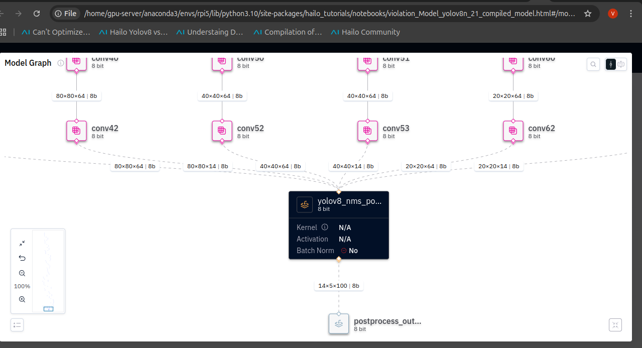

Hi i geting ERRor Negative Slope ExponentNonFixable
Negative Slope ExponentNonFixable: Quantization failed in layer custom_violation_model_700epoch_v2/conv83 due to unsupported required slope. Desired shift is 19.0, but op has only 8 data bits. This error raises when the data or weight range are not balanced. Mostly happens when using random calibration-set/weights, the calibration-set is not normalized properly or batch-normalization was not used during training. @Nadav @omria @Omer
plz any one tell me why this error ocured an how to solve it
Hi @vinaygouda.ttssl,
As the error message says, this issue usually happens when there are issues with normalization/calibset/weights. Could you share the following details with us:
  1. Model architecture
  2. Model script used
  3. How calibset was created
Model architecture yolov8
Calibration set has been created as per the hailo tutorials
please try this solution:
@omria @Marina_Vilela_Bento @Omer plz any one can give the solution for this plz ---------------------------------------------------------------------------

after converting model to hef the detections are not as accepted can you help me out
why yolov8 nmspostprocess shows N/A even i pass nms config.json while converstion model from yolov8n to hef model plz give ans @Omer @Marina_Vilela_Bento @omria @Nadav
The kernel and activation are N/A because they are not relevant for the nms postprocess.
