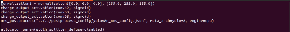

It looks good. The alls_script points to an yolov8n.alls, could you please also share the commands in that file?
I found a single file yolov8n.alls in the directory:
(hailo_virtualenv) hailo@sensorama-ubuntu-pc:/local/shared_with_docker$ find /local -name “yolov8n.alls”
/local/workspace/hailo_model_zoo/hailo_model_zoo/cfg/alls/generic/yolov8n.alls
@vlad.purhin The error message means that there is an issue with the nms postprocess which is configured in the yolov8n_nms_config.json mentioned in the yolov8n.alls.
This can happen when the model being used has different layer names than the original pre-trained one. You may have to change the bbox decoding layer names (after parsing),:
You can visualize parsed models with netron.app.
Another option is editing the model script to not use the ModelZoo NMS config JSON. This can be done by removing the NMS JSON path from the nms_posprocess command in the model script. We have a preview feature that automatically finds the correct bbox decoding layers during parsing and it is then used during the optimization.
