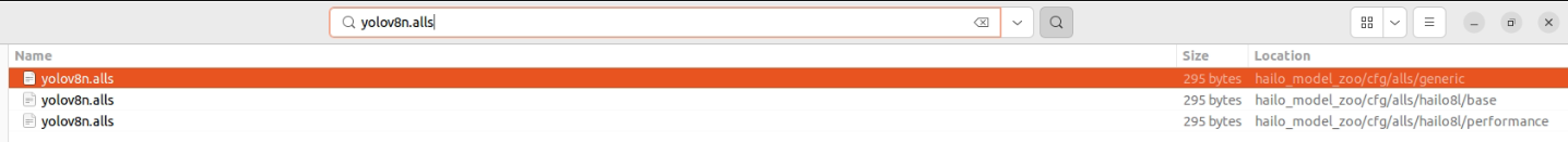

I don’t understand where the error is, because the yolov8n.alls file is in the generic folder and I also moved it to the hailo8l folder
Please, help me with this problem.
