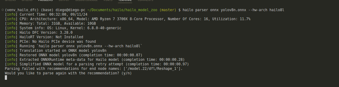

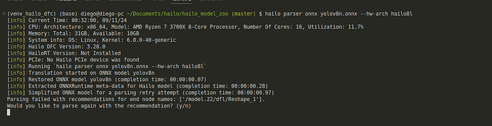

- I encountered different versions of an error where I was suggested to use “parse recommendation.” One was “[‘/model.22/dfl/Reshape_1’],” and others suggested “[‘/model.22/Sigmoid’,‘/model.22/dfl/Reshape_1’],” and I even encountered one that had 4 nodes to recommend me.

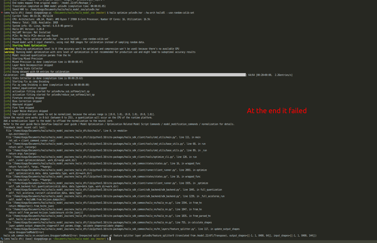

- In the end, it managed to parse, but when running the optimize step, it failed.
I am doing this with the following command: hailo parser onnx yolov8n.onnx --hw-arch hailo8l
I also tried: hailomz compile yolov8n --ckpt=yolov8n.onnx --hw-arch hailo8l --classes 2 --performance
Without success. I have DFC installed correctly, and it doesn’t give me any errors; I can run “hailomz” and “hailo.”
