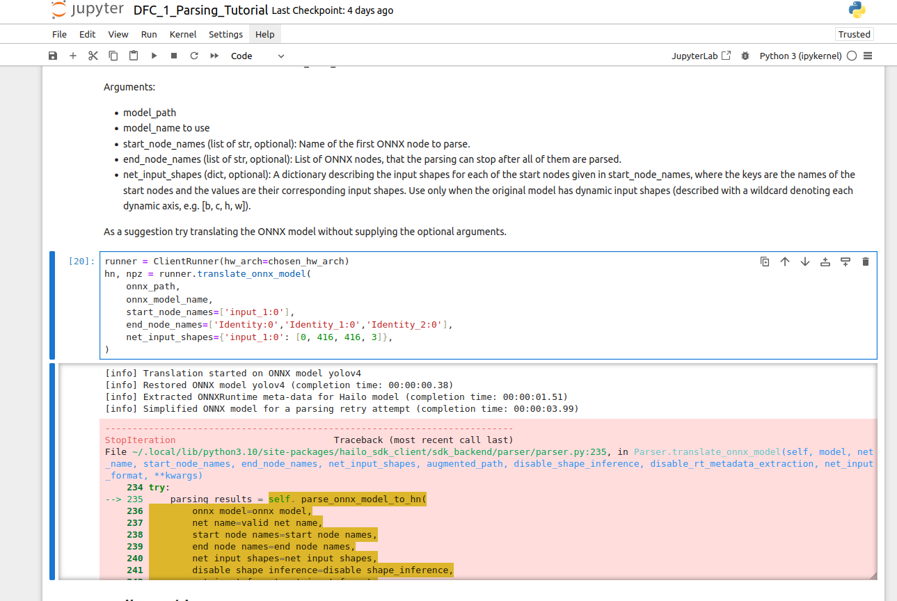

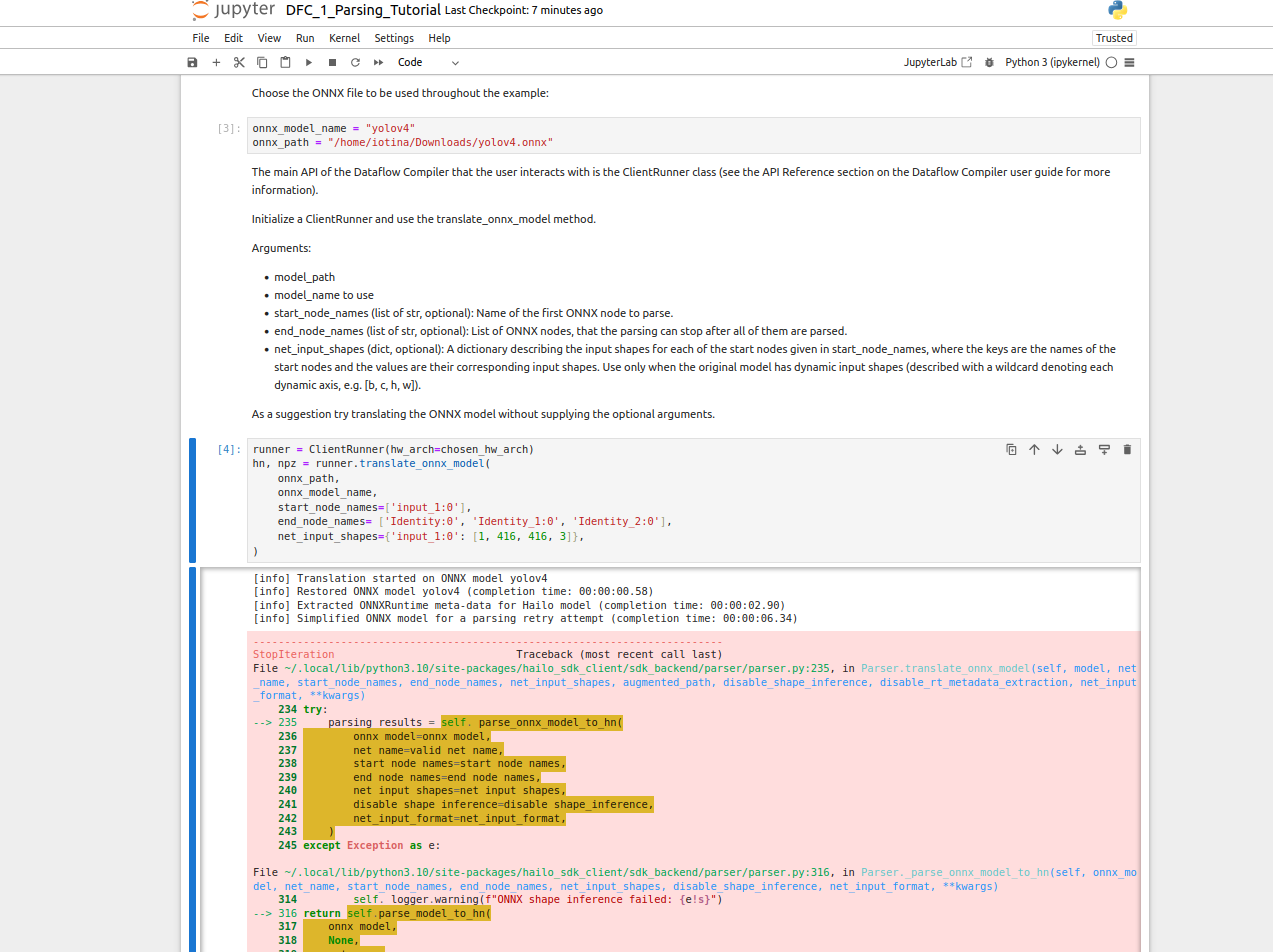

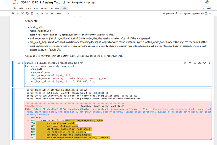

I need to convert an open source onnx based model to hef based model , so for that i downloaded the DFC and ran the basic example and that was successful,but now when i do the same steps but with the other models that i downloaded from the onnx repo, so I get error I also tried with multiple different open source model , no one was able to be successfully parsed. The error atleast for this is
Now Guide me how do i make it ,compile successful , not only this i want to compile any of the opensource model,Guide me if I’m missing some technical details for the conversion.

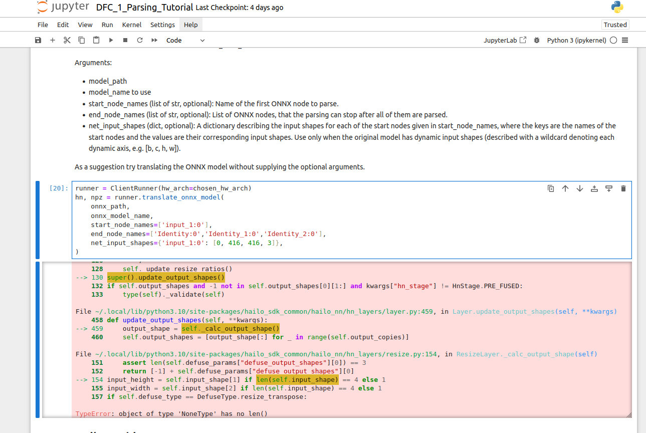

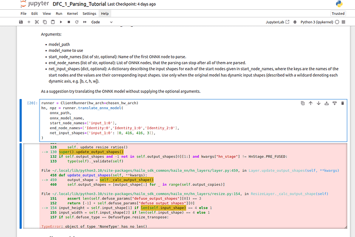

5. Troubleshoot Specific Errors
  • NoneType Error in Output Shapes: This error usually indicates that certain layers lack defined output shapes, often due to unsupported or complex operations. Run onnx.checker.check_model to validate that the ONNX model adheres to ONNX standards.
  • StopIteration Error: This error typically arises from incomplete parsing due to missing or incorrect node names. Double-check that start_node_names and end_node_names match nodes within the model.

Thanks @omria , I followed these steps
  1. I ran this code to print the output of the layers
    import onnx model = onnx.load('/home/avinash/Downloads/yolov4.onnx') for node in model.graph.node: print(node.op_type,end=" ")
    So it has few differences with the Hailo supported so i tried
`python3 -m onnxsim yolov4.onnx yolov4.onnx
Simplifying...

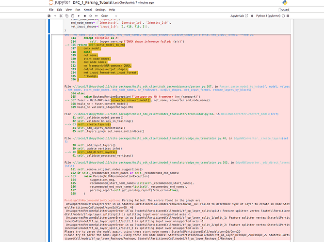

After executing all this the shape,start_node ,End Node are
python3 shape.py
Input names: ['input_1:0']
Output names: ['Identity:0', 'Identity_1:0', 'Identity_2:0']
Input shapes:
input_1:0: [1, 416, 416, 3]
Before Shape Convert
python3 shape.py
Input shapes:
input_1:0: [0, 416, 416, 3]
But After doing all this i’m still getting error like this
Also is there any way like you mentioned by Hailo sdk so is there any command hailo_sdk_client inspect or something by which one get to know whether the model is hailo compatible or not.
Because onnx Simplifier does not did a job.
Hi @UHailo,
We offer yolov4 in our ModelZoo. If you didn’t re-train it, you can download an already compiled model from there. Otherwise, I would recommend using our re-training docker.
