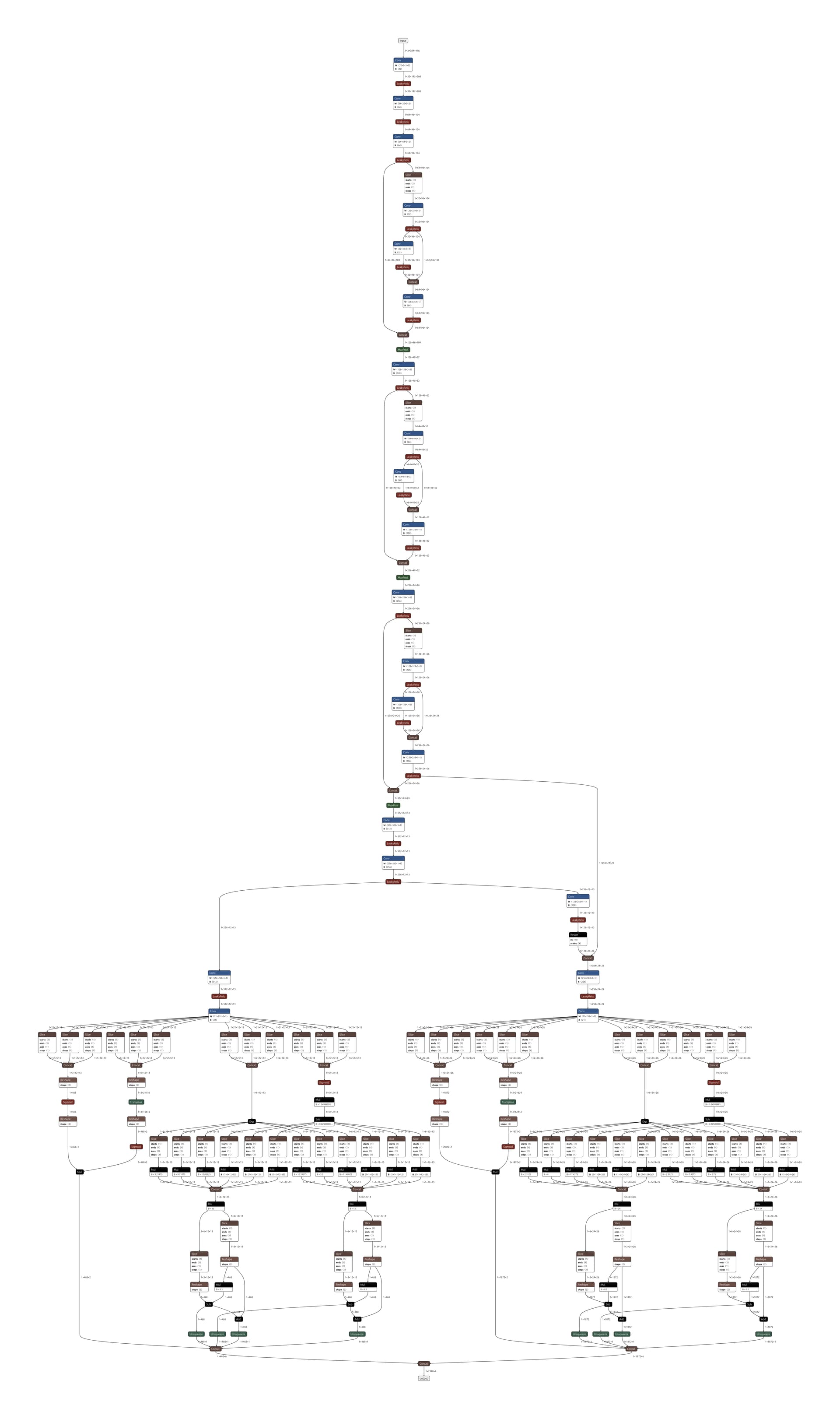

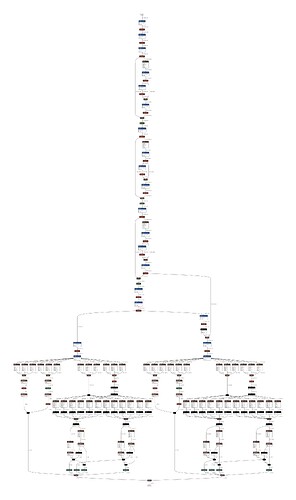

Please try to parse the model again, using these end node names: /37/Slice_27, /37/Slice_26, /37/Transpose, /30/Transpose, /37/Concat_2, /37/Slice_24, /30/Slice_24, /30/Slice_27, /30/Concat_2, /30/Slice_26, /30/Slice_25, /37/Slice_25
The hailo dataflow compiler does not appear to support the operations from reshape and below in this network. Am I correct to think I can set the end nodes to the concats just before, finish the conversion, then implement the post processing that I left out (reshapes and below) in python with something like numpy?
end_node_names = [
“/30/Concat_2”, “/30/Concat_3”, “/30/Concat_1”, “/30/Concat_3”, “/30/Concat”, “/37/Concat_2”, “/37/Concat_3”, “/37/Concat_1”, “/37/Concat”
onnx_path,
onnx_model_name,
start_node_names=[“input”],
end_node_names=end_node_names,
net_input_shapes={“input”: [1, 3, 384, 416]},
Yes, some networks contain operations, often at the beginning or/and end, that are not supported on the Hailo-8 which will need to be excluded from the conversion process and implemented on the host in the language of your choice.

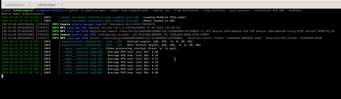

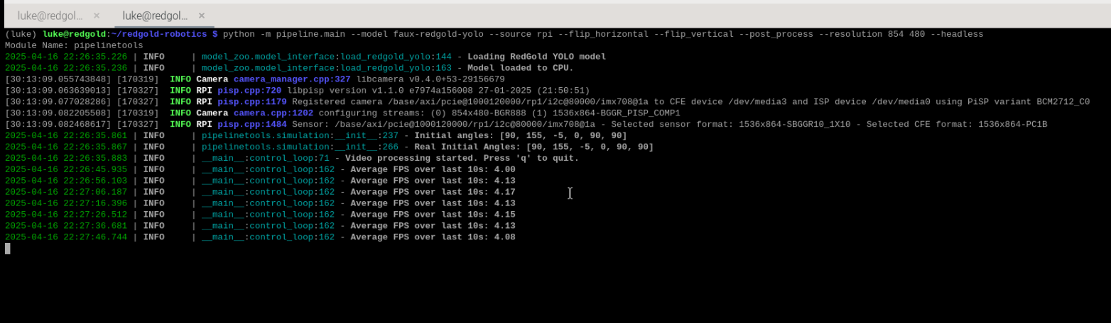

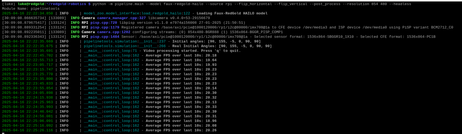

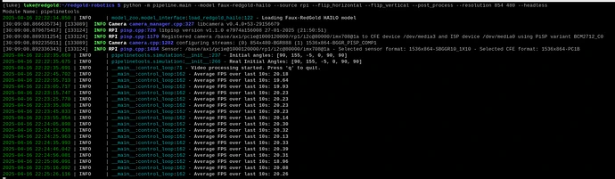

Mission complete. I am seeing 20 fps in with the model implemented in my code base.
I began with a darknet yolov4tiny model (cfg, weights), and first converted to onnx. Then, using the hailo tutorial jupyter notebooks, I converted that onnx model up to the lowest end nodes possible. Full translation was not possible due to unsupported operations (shuffle operations like reshape). I visually inspected the onnx model using https://netron.app, and identified which nodes i should select. After completing the tutorial and receiving a .hef, I then moved to split the .onnx model using graphsurgeon. This split model allows for me to post-process the output of the hef model using onnxruntime. The input nodes to the post-process onnx model must be modified to match the names of the hef output.
