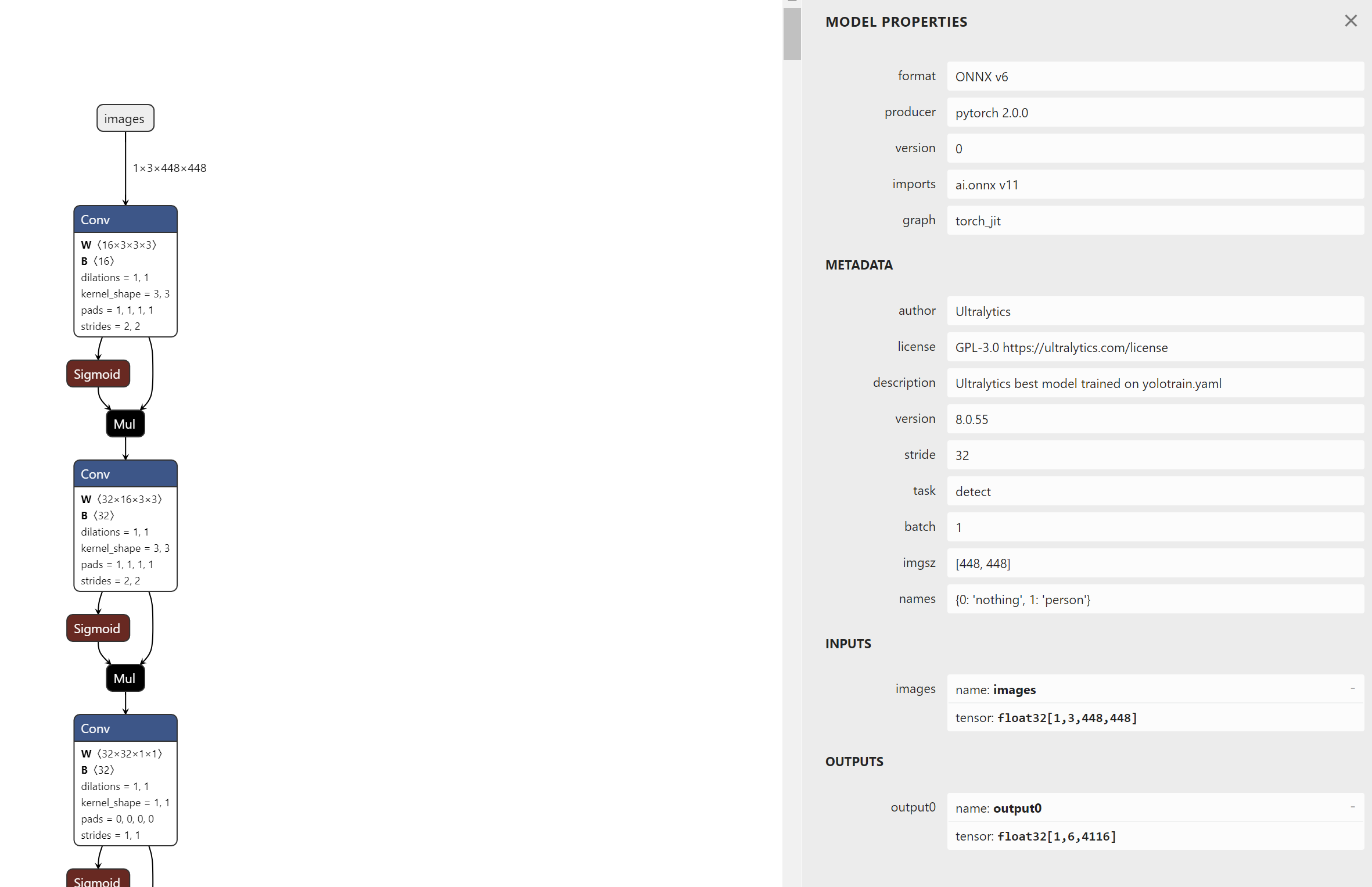

Maybe the model is bad? It’s a re-trained yolov8m model but should be pretty standard. Here’s the ONNX visualizer for the input for the model the HEF is converted from:
Hey @jrblkbelt
It sounds like you’re encountering multiple issues when running inference on your retrained YOLOv8m model with the Hailo SDK. Here are some suggestions to help debug and resolve the problems:
  1. Buffer Error: The buffer issue you’re seeing could be due to a mismatch in the input/output dimensions or data types. From the ONNX visualizer, your model expects input with the shape float32[1, 3, 448, 448] (batch size 1, 3 channels, 448x448 image), and output float32[1, 6, 4116]. Make sure you’re passing inputs with the correct shape and normalization (values between 0 and 1).
