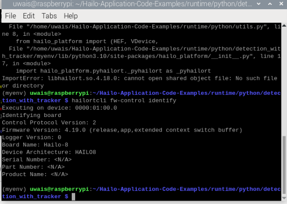

Subject: ImportError: libhailort.so.4.18.0 Missing in Hailo Detection Example
Description:
I am encountering an issue while running the detection_with_tracker.py script from the Hailo Application Code Examples. The script fails to start due to a missing shared library (libhailort.so.4.18.0). Below are the details:
  File "/home/uwais/Hailo-Application-Code-Examples/runtime/python/detection_with_tracker/detection_with_tracker.py", line 16, in <module>
    from utils import HailoAsyncInference
  File "/home/uwais/Hailo-Application-Code-Examples/runtime/python/utils.py", line 8, in <module>
    from hailo_platform import (HEF, VDevice,
  File "/home/uwais/Hailo-Application-Code-Examples/runtime/python/detection_with_tracker/myenv/lib/python3
see what prints in the terminal when you enter this

This is what i get .Can you try installing and running the code without any python environment
Also for the error that you are getting
try to check if you have 4.18 /4.19 is installed
sudo find /usr/ | grep libhailort
refer this link HAILO_CONTROL_OPCODE_POWER_MEASUEMENT is not supported on the current board. [HailoRT] [error] CHECK_SUCCESS failed with status=HAILO_UNSUPPORTED_OPCODE(48) Failed to get power measurement results, status - #4 by prasaanthg
