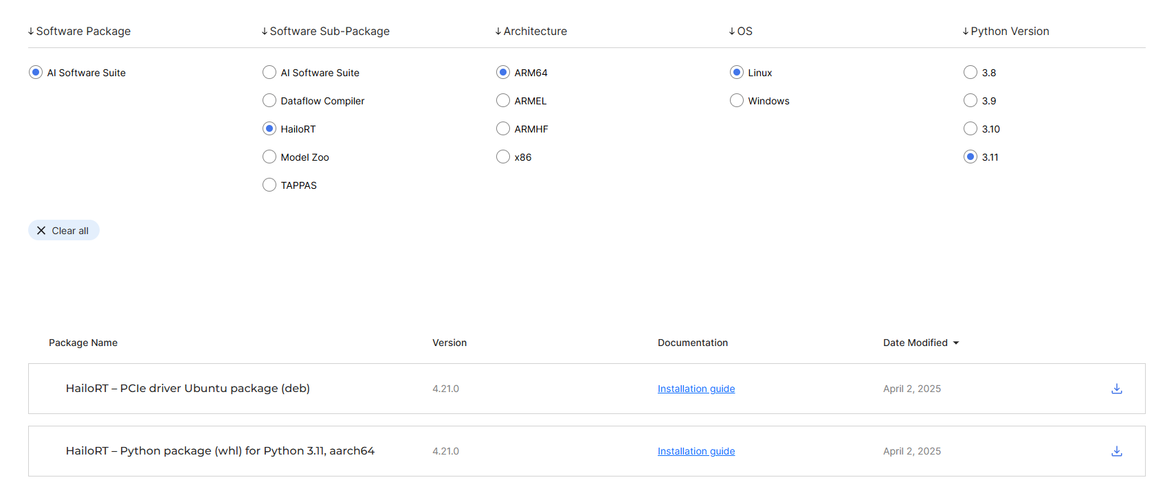

(1) Downloads hailoRT 2 files(.deb, whl) [https://hailo.ai/developer-zone/software-downloads/]
  • my setting : aarch64/linux/python3.11
(2) In RaspberryPi5, i made venv and install object_detection requirements.txt

(4) I checked pkg files, they already installed
>> dpkg -l | grep hailort
ii  hailort                               4.20.0-1                            arm64        HailoRT
ii  hailort-pcie-driver                   4.21.0                              all          Hailo PCIe driver and firmware
ii  python3-hailort                       4.20.0-1                            arm64        HailoRT Python API, which wraps the runtime library
