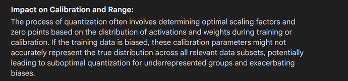

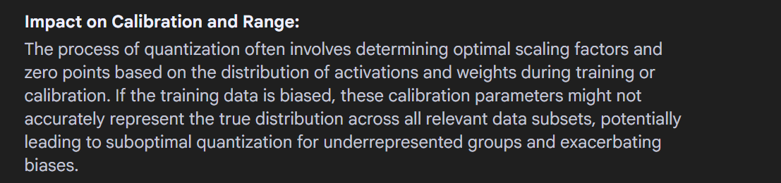

Based on my research it could be possible if you don’t follow hailo recommendatation size. As I know, your calib dataset size is 1024 which should be sufficient. Some of below links say that it could be counterproductive if you use more dataset on calib dataset which might affect the range of minimum/maximum activation value. In your case it not a problem, though, since you use the correct number of calibration datasets, I believe. Did you check the bias in the training dataset
On the Impact of Calibration Data in Post-training Quantization and Pruning - ACL Anthology
SelectQ: Calibration Data Selection for Post-training Quantization | Machine Intelligence Research
Make sure that you only have label picture in your calib. set.
My training dataset consists of 100,000 images. Should I use the entire dataset as the calibration dataset except non labeled background images? Or would it be sufficient to select 1024 images containing labeled objects from the training dataset?
if you use non label images in your calibration dataset it will destroy the hef file
The code copilot gives me look in the label file and randomize takes pictures to make a calib. directory. my data set is only on 2000 images with around 1000 fake and that is not enough to make sure that the youlo11s file is detecting ONLY my dog. i need to provide around 1500 more fake images of dogs. So it is important to only select label images to the hailo compiler.
Okay, I realized my calibration dataset contained 60% non-object images (background) and 40% images with objects. I have now made it 100% object-containing images. It’s compiling again now. After I get the model file, I will inform you. The only issue is that one layer is not learning at all. This layer is most likely related to large objects. My calibration dataset does include some of these large objects, but could the problem be due to their insufficient amount? I am sharing part of my logs. Thank you
