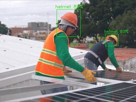

using python3.9 + hailo_ai/yolo .pt model to .onnx, add opset and imgsz
yolo export ....   imgsz=640 format=onnx opset=11
Then can convert
Although the conversion speed is slow and it seems to be a 4-context model, it is successful
Hi @kok.bing, for less contexts make sure to enable the maximum optimization level for the compilation.
