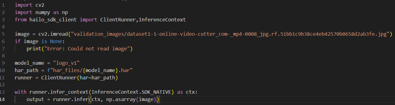

after some digging, i found the emulator part on the DFC documentation page 76, but im not sure how to use it, i didn’t find what the input data supposed to be, so i just put in an image as array
then i got this error:
Inference: 0entries [00:00, ?entries/s]Traceback (most recent call last):

I found the problem, the input color needs to be converted, im using
img = cv2.cvtColor(img, cv2.COLOR_BGR2RGB)
so I when i was looking for an inference script, I came across this topic , then I modified the script a bit, I tested the HAR file and it worked flawlessly, then i noticed the color conversion, took me 5 weeks to figure this out…
here’s my host machine inference script if anyone’s interested
