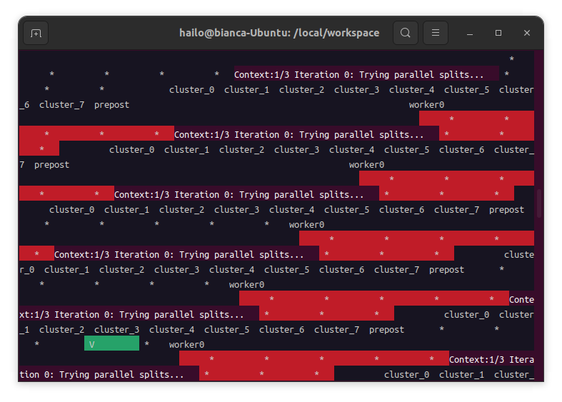

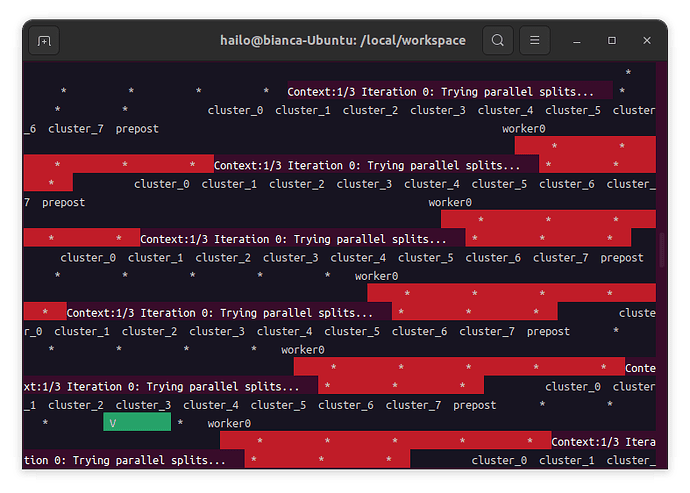

  1. Compile Model
  • Some errors occurred during compilation. Could these errors be affecting model precision?
  • Command Line:
hailomz compile yolov8s --hw-arch hailo8l --har /local/workspace/yolov8s.har --classes 8

This is expected behavior of the compilation process. The compiler tries to allocate your network onto the chip. This is a type of puzzle where some allocations do not work and the compiler will try other options.
