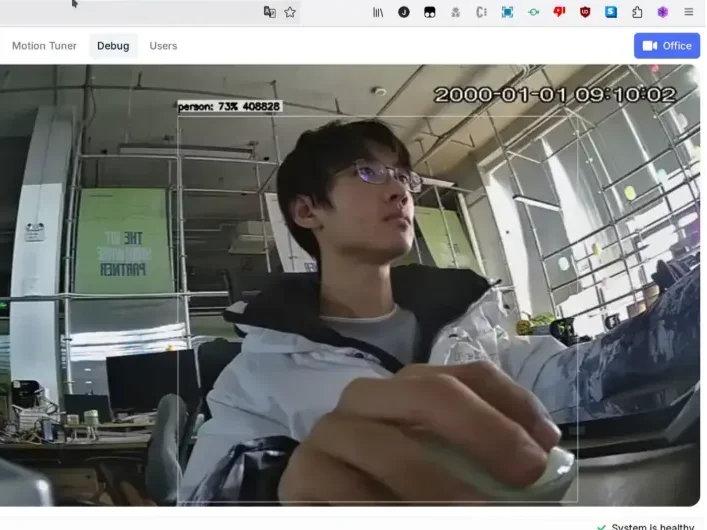

Here is an example of how to use frigate on raspberrypi5 and hailo8
I have tried use yolov8n object detection model on frigate, and here is an example about how to train yolov8n please use the hailo 4.20 DFC :slight_smile:
I have seen those. It may work for coco example model, but not really for my custom model.
With adjusted alls I posted in my 2 post, it works. But I’m not getting accuracy I need and some false positives.
How do you use 4.20 with rpi image? frigate image is build with 4.19. From what I seen here, it is not recommended to mix versions.
