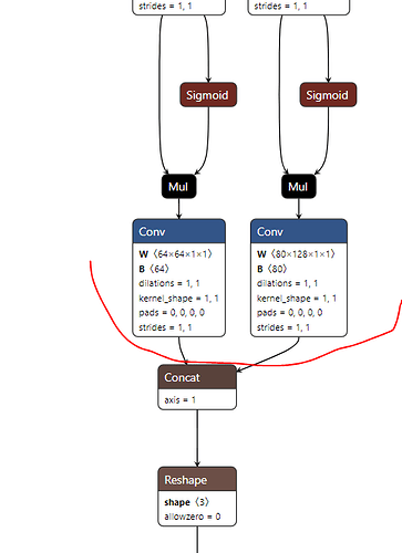

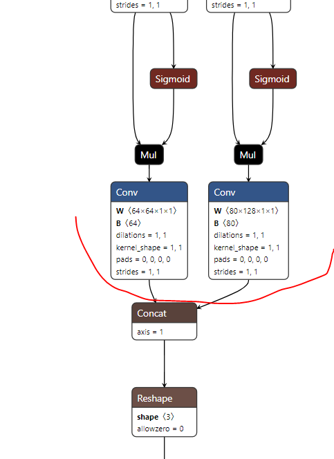

!hailo parser onnx /workspace/yolov8n.onnx --net-name yolov8n --har-path /workspace/yolov8n.har --start-node-names images --end-node-names /model.22/Sigmoid /model.22/dfl/Reshape_1 --hw-arch hailo8

- Parsing Issue with “output1” End Node: Why does the parsing fail when I specify “output1” as the end node? Does specifying different output nodes affect the architecture saved in the HAR format?
