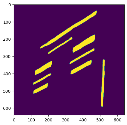

My task is to translate a onnx model to hef.
At the beginning, the input of onnx is dynamic like['batch', 3, 'ax1', 'ax2']
I test this model it using onnxruntime on Python3:
ort_sess = onnxruntime.InferenceSession("./ppocr_det.onnx")
print(ort_sess.get_inputs()[0])
ort_inputs = {ort_sess.get_inputs()[0].name: x}
ort_outs = ort_sess.run(None, ort_inputs)
and it returned correctly.

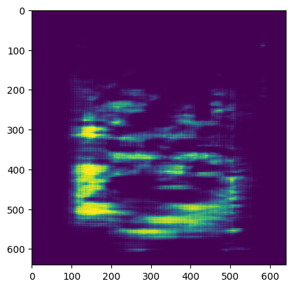

with runner.infer_context(InferenceContext.SDK_NATIVE) as ctx:
native_res = runner.infer(ctx, img)
At this point, a completely incorrect return value was obtained.
My question is:
- The input dimension of onnx is
[1, 3, 640, 640], while the input dimension of the har file I obtained is[-1, 640, 640, 3]. Is this correct? What do these dimensions refer to respectively? - I tried to use the same image as Input of onnx and har. For the har file, I tried to skip the transport step and keep the [h, w, c] format as input. Unfortunately, I got completely different return, how can i fix it?
