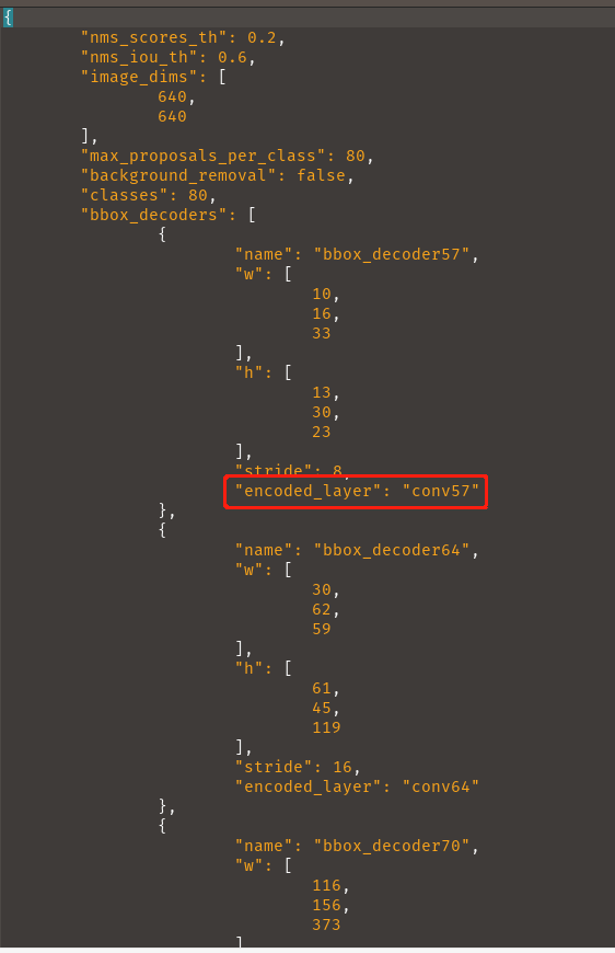

I tried running the following command:
hailomz optimize --hw-arch hailo8 --har ./yolov5s_c3tr.har yolov5s_c3tr
and got the following error:

hailo_sdk_common.hailo_nn.exceptions.HailoNNException: The layer named conv64 doesn't exist in the HN
I don’t understand what encoded_layer refers to, and how to determine which one it is in the onnx model I converted?
