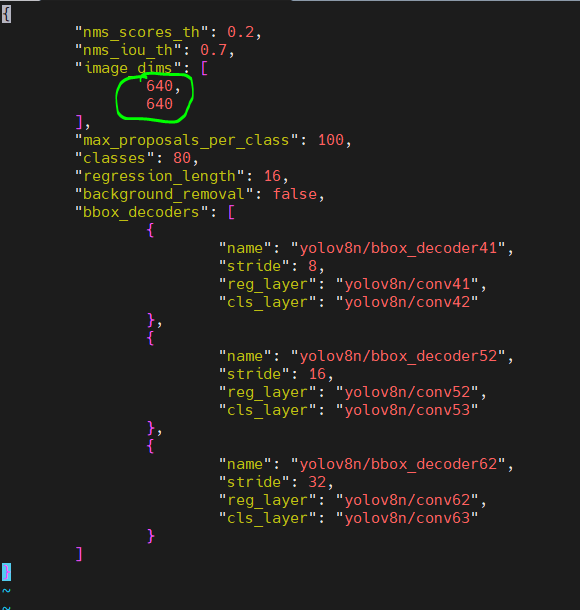

Hi @Thor,
What’s your model’s input resolution? it seems that the MZ script is trying to assign the nms postprocess but it encounter some issue.
Regards,
Hi @Omer
Model resolution is 800x800
Hi @Thor,
So you need to update the yolov8n_nms_config.json file with the correct input dimensions:
Regards,
