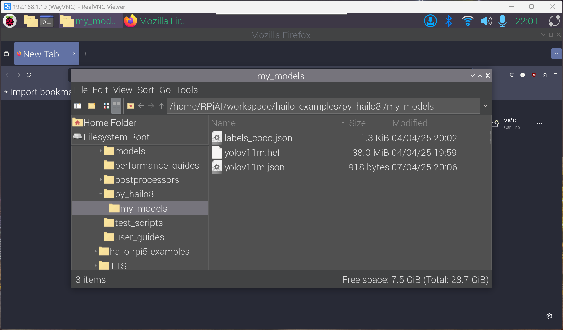

Hi @Loi_Tran
Can you please confirm the contents of this folder? /home/RPiAI/workspace/hailo_examples/pySDK/my_models
Hi @Loi_Tran
Please enter any dummy value for checksum. The actual value does not matter as long as it is not left empty.
Here. Thanks very much!
Thanks @Loi_Tran for sharing this. Please add some dummy value to checksum and try again (do not leave the string empty).
Thanks @shashi for reply!

Hi @Loi_Tran
In your code you have model_zoo = '/home/RPiAI/workspace/hailo_examples/pySDK/my_models' but the model files seem to be located at '/home/RPiAI/workspace/hailo_examples/py_hailo8l/my_models'. Hope you can see the difference: pysdk instead of py_hailo8l.
Hi @shashi
I just wanted to say a big thank you for taking the time to help me fix that code bug. I was really stuck, and your support made a huge difference. I truly appreciate your patience and your willingness to jump in and assist.
