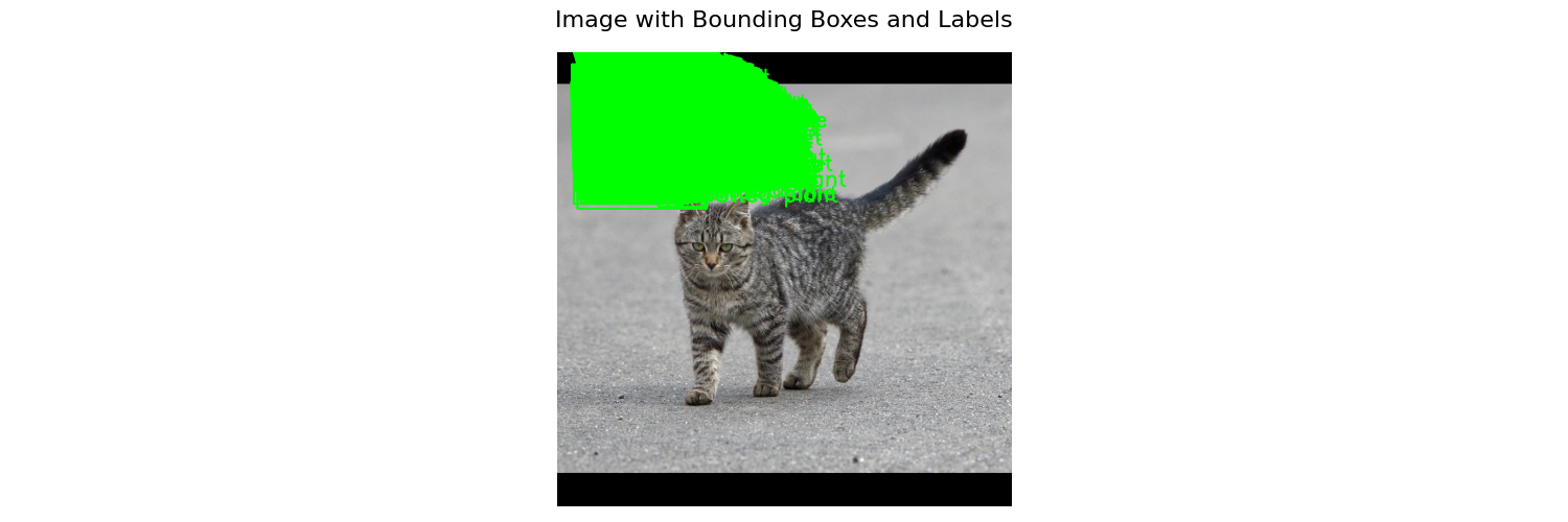

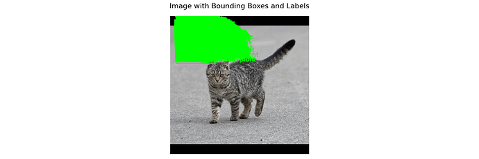

Hi, local host is done, thanks! but i have a new problem: I try to inference with yolo8n pretrained coco models on your user guide 2 with cat. but I get bad result
I think there are all of possible 80 classes.
my json
    "ConfigVersion": 10,
    "Checksum": "d5f1b2e5c1b7e1e8d9a4c3b2a1f0e9d8c7b6a5f4e3d2c1b0a9f8e7d6c5b4a3",
    "DEVICE": [
            "DeviceType": "HAILO8",
            "RuntimeAgent": "HAILORT",
            "SupportedDeviceTypes": "HAILORT/HAILO8"
    "PRE_PROCESS": [
            "InputType": "Tensor",
            "InputN": 1,
            "InputH": 640,
            "InputW": 640,
            "InputC": 3,
            "InputRawDataType": "DG_UINT8"
    "MODEL_PARAMETERS": [
            "ModelPath": "best1.hef"
    "POST_PROCESS": [
            "OutputPostprocessType": "None"
