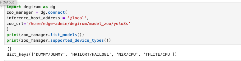

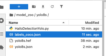

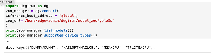

@shashi
I am running into the same issue discussed with another user where degirum is not able to local my model
In my case, I am using yolov8s with my custom dataset. Does this method only support yolov11n?
I see there are specifics about naming conventions. I dropped ‘v’ in the naming used in my model zoo however it still is unable to locate my model.
Here are the contents of my json file:
Blockquote
“ConfigVersion”: 10,
“DEVICE”: [
“DeviceType”: “HAILO8”,
“RuntimeAgent”: “HAILORT”,
“SupportedDeviceTypes”: “HAILORT/HAILO8”
“PRE_PROCESS”: [
“InputType”: “Image”,
“InputN”: 1,
“InputH”: 640,
“InputW”: 640,
“InputC”: 3,
“InputPadMethod”: “letterbox”,
“InputResizeMethod”: “bilinear”,
“InputQuantEn”: true
“MODEL_PARAMETERS”: [
“ModelPath”: “yolo8s.hef”
“POST_PROCESS”: [
“OutputPostprocessType”: “Detection”,
“PythonFile”: “HailoDetectionYolo.py”,
“OutputNumClasses”: 80,
“LabelsPath”: “labels_coco.json”,
“OutputConfThreshold”: 0.3
Hi @mikepwright
Please see the comment here: User Guide 3: Simplifying Object Detection on a Hailo Device Using DeGirum PySDK - Guides - Hailo Community. You need to add one more field to the JSON called CheckSum.
