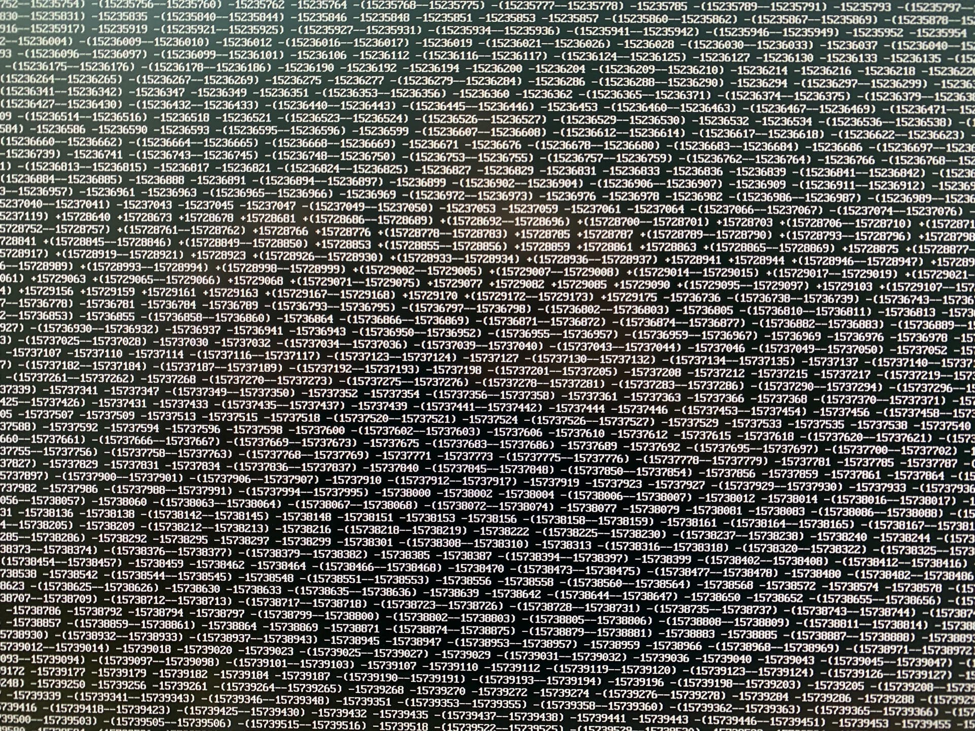

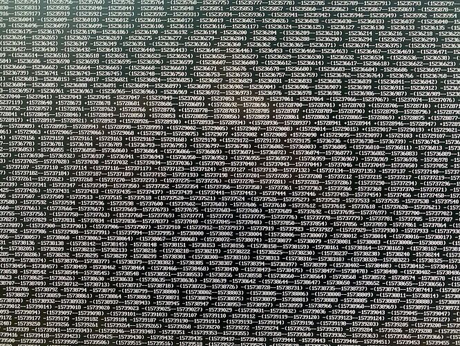

I seem to have an issue when enabling PCIe 3. When I try to boot up after changing the setting, I just get strange numbers counting upwards forever. In order to boot, I have to take out the SD card and change the config.txt again.
