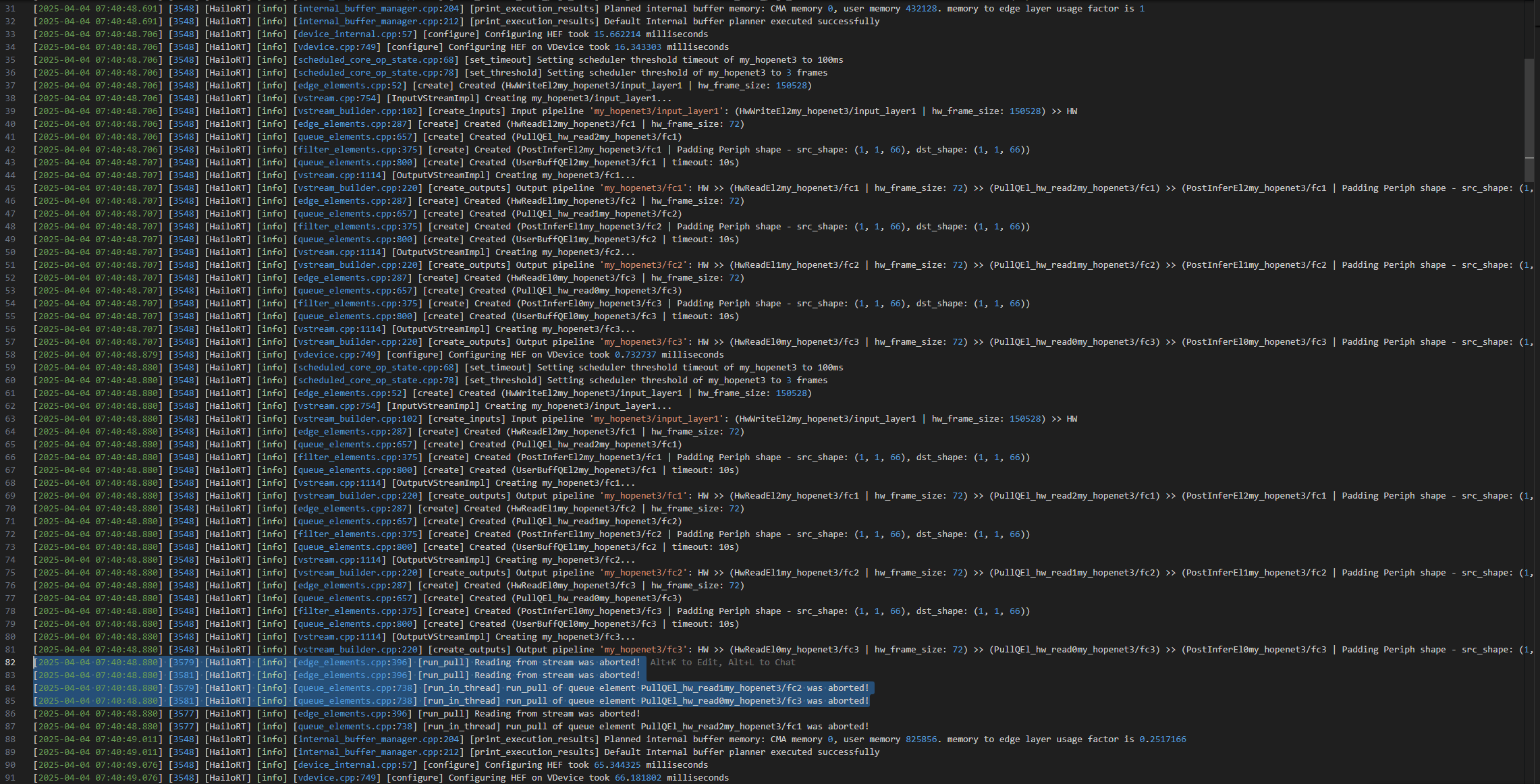

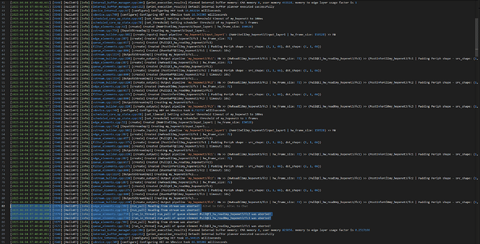

I have also attached the hailort.log file where the error occurred.
There are abort logs like this.
"[2025-04-04 07:40:48.880] [3579] [HailoRT] [info] [edge_elements.cpp:396] [run_pull] Reading from stream was aborted!
[2025-04-04 07:40:48.880] [3581] [HailoRT] [info] [edge_elements.cpp:396] [run_pull] Reading from stream was aborted!
[2025-04-04 07:40:48.880] [3579] [HailoRT] [info] [queue_elements.cpp:738] [run_in_thread] run_pull of queue element PullQEl_hw_read1my_hopenet3/fc2 was aborted!
[2025-04-04 07:40:48.880] [3581] [HailoRT] [info] [queue_elements.cpp:738] [run_in_thread] run_pull of queue element PullQEl_hw_read0my_hopenet3/fc3 was aborted!"
I have reviewed the Hailort application example code and guides, and found that the example code and execution flow are similar.
However, an abort occurs at the NPU level, making it unclear what specific aspects I should investigate.
