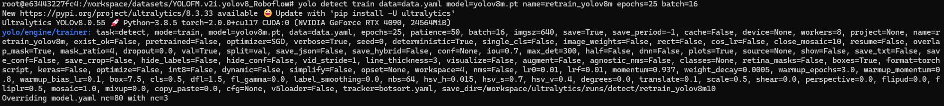

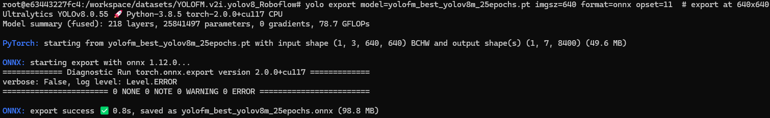

I’m doing a model retraining, and it works alright while using the model zoo yolov8 docker, so I can do the training and export, as below:
But when changing to the hailo docker for the compilation, GPU is not detected.

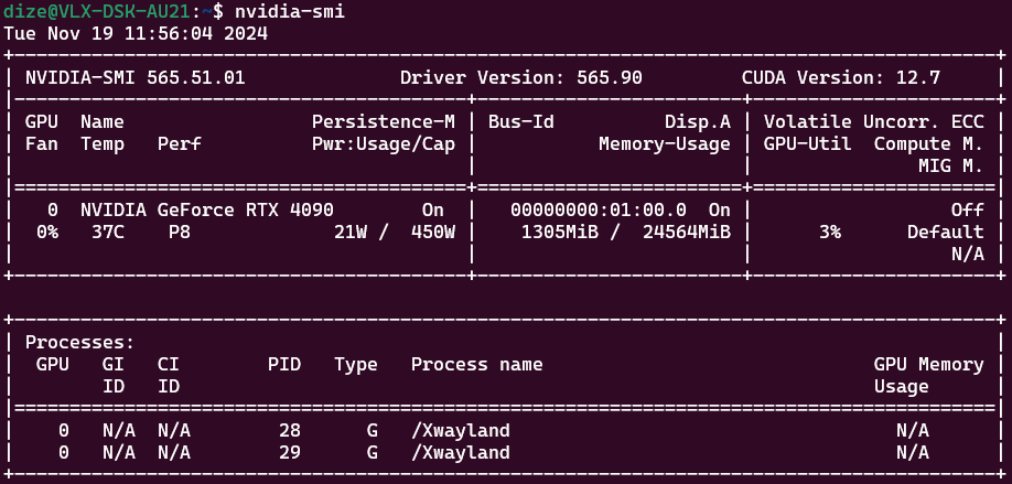

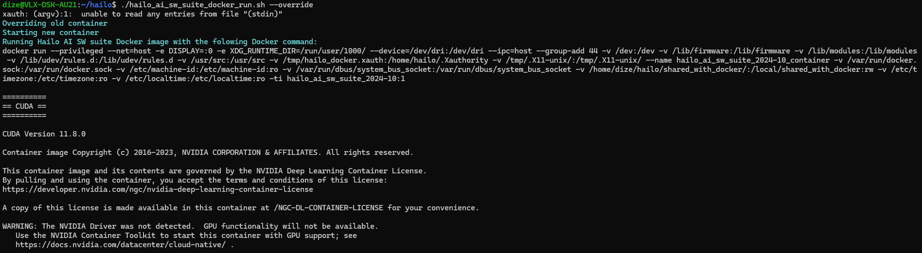

Running nvidia-smi inside the Hailo docker says “command not found”. Running it outside, runs and detects the GPU:
The second command returns: 565.90

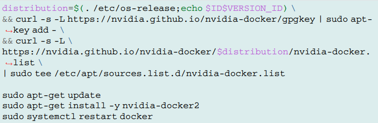

The second indicates you did not install NVIDIA docker support. Make sure you install nvidia-docker2 support. See Hailo AI SW Suite User Guide for detailed instructions.
@Klaus_Koschinsky

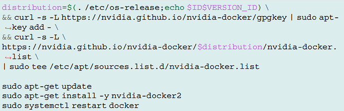

I remember installing docker2 before, but just tried it again as per Hailo AI Suite instructions below:
The first bit, distribution, it gives an error message.
Typing the other commands seem to work.

Installing nvidia-docker2 does not work with the current instructions. I guess that Nvidia have changed something in their Github repo. The command:
distribution=$(. /etc/os-release;echo $ID$VERSION_ID) \
&& curl -s -L https://nvidia.github.io/nvidia-docker/gpgkey | sudo apt-key add - \
&& curl -s -L \
https://nvidia.github.io/nvidia-docker/$distribution/nvidia-docker.list \
| sudo tee /etc/apt/sources.list.d/nvidia-docker.list
gives the following error message:
Warning: apt-key is deprecated. Manage keyring files in trusted.gpg.d instead (see apt-key(8)).
OK
# Unsupported distribution!
# Check https://nvidia.github.io/nvidia-docker
So even though my GPU is detected with nvidia-smi at version 550.120 it is not appearing within the container.
