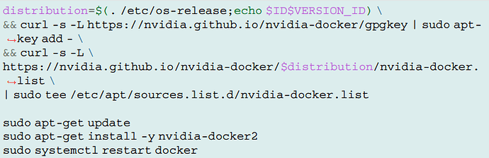

  • Install Nvidia driver 525 outside the docker, to have better compatibility with CUDA 11.8 (used inside the docker).
  • Make sure that to install nvidia-docker2, as explained in the Hailo AI SW Suite User Guide

I have installed nvidia-docker2 but that doesn’t seem to change anything.

Please do the following:
  • Stick with Nvidia driver 535, if you cannot modify it. Make sure the GPU is working correctly outside the docker.
  • Make sure you followed these instructions ton install nvidia-docker2
  • Delete the docker container and create a new one

Indeed, in order to detect the GPU correctly, the run docker script performs the following checks the first time it is launched:
lspci | grep "VGA compatible controller: NVIDIA" dpkg -l | grep 'nvidia-docker\|nvidia-container-toolkit'
This means that:
  • nvidia-docker2 must be installed before creating the container
  • the GPU device must appear as a “VGA compatible controller”. Your device - listed as a “3D controller” - was filtered out by the grep "VGA compatible controller: NVIDIA" command.
This is under investigation and will be fixed in the next releases.
If you want to use the GPU in the docker, you can we modify the grep command in the docker script to look for both “VGA compatible controller: NVIDIA” and “3D controller: NVIDIA”. Then you can create a new container.
