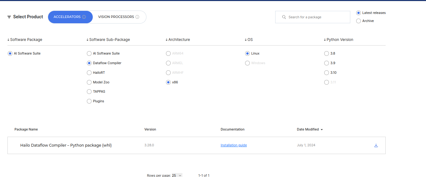

· Go to Hailo website The World’s Top Performing Edge AI Processor For Edge Devices .
· Login to Developer Zone
· Go to SW Downloads page Software Downloads | by Hailo the leading AI Processor company
· There are two buttons:
  • Hailo Software Suite: the software suite and its associated components (DFC, Hailo-RT, Model Zoo, Tappas) are released every quarter. Select this button if you want to download a DFC release that coincides with a software suite release.
  • Archives released: select this button if you want to download older release.
For this present document, we’ll select ‘Hailo Software Suite’ to download the DFC that coincides with the latest SW suite.
In the Product section, select Dataflow_Compiler. Note that the OS is ‘Linux’ by default and it is the only option at this time, that’s why we need WSL2 to support it on Windows.
Download the wheel Hailo Dataflow Compiler - Python package vX.YY. Here, we are assuming here that the downloaded filename is hailo_dataflow_compiler-3.28.0-py3-none-linux_x86_64.whl and it is downloaded in your ~/Downloads folder . Go to your ubuntu terminal and type:
