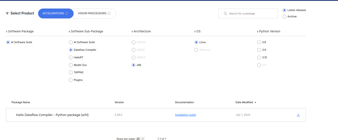

In the Product section, select Dataflow_Compiler. Note that the OS is ‘Linux’ by default and it is the only option at this time, that’s why we need WSL2 to support it on Windows.
Download the wheel Hailo Dataflow Compiler - Python package vX.YY. Here, we are assuming here that the downloaded filename is hailo_dataflow_compiler-3.28.0-py3-none-linux_x86_64.whl and it is downloaded in your ~/Downloads folder . Go to your ubuntu terminal and type:
