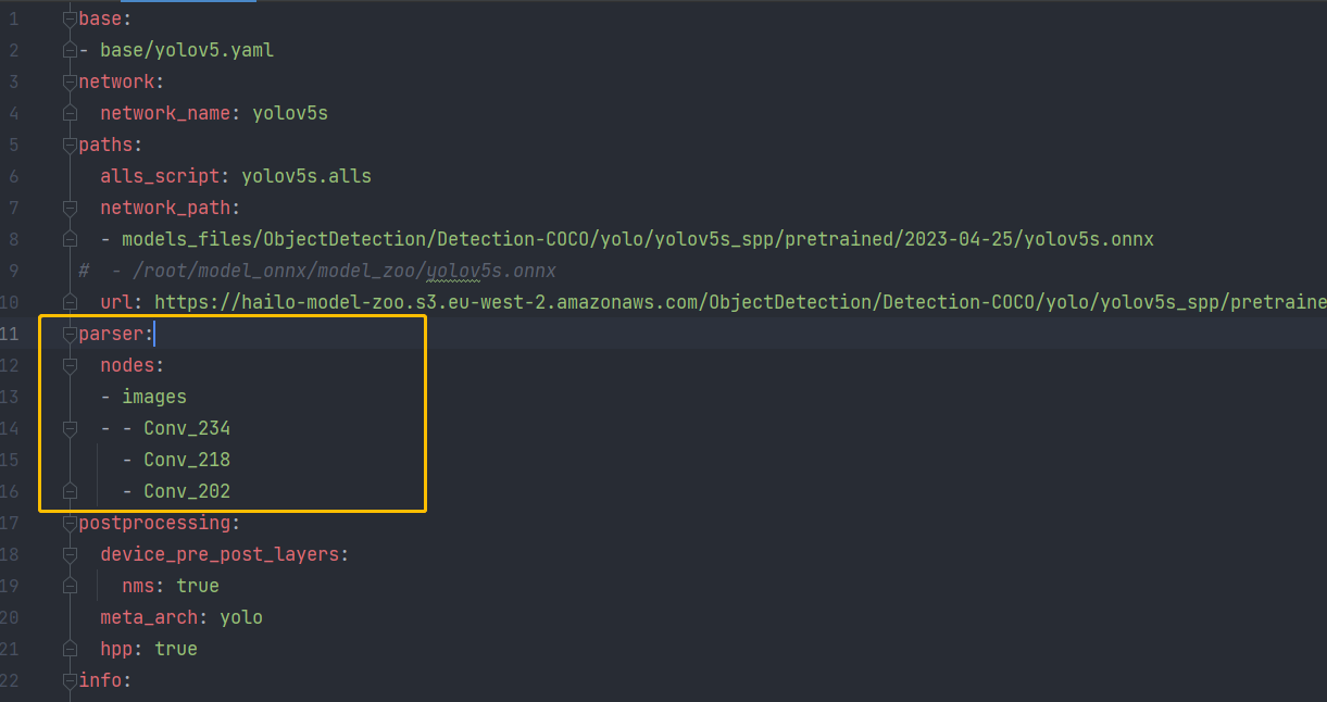

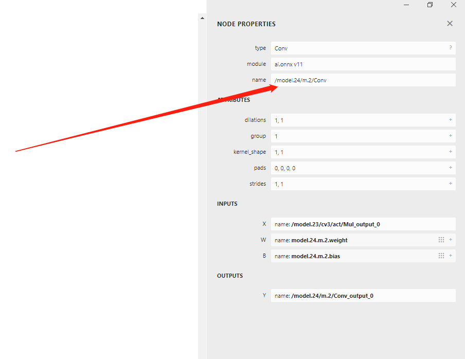

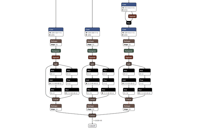

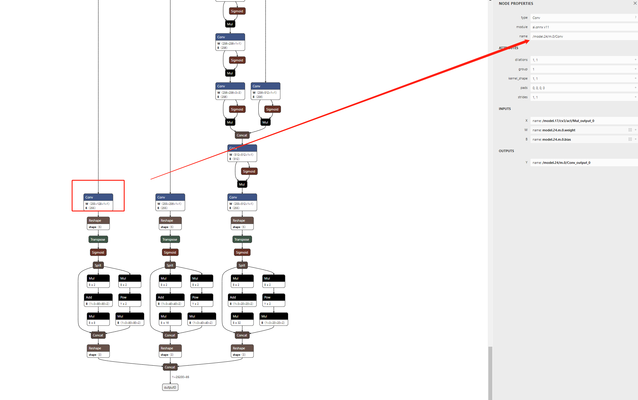

Hi @KNN2157, can you share a picture of Netron with the last Conv’s of hte ONNX? It might be the the end node names are different on your ONNX file.
sure
by the way I have no problem using your yolov5s.onxx to convert.Might as well look at the new problem About DFC and hailo_zoo_model - #11 by KNN2157

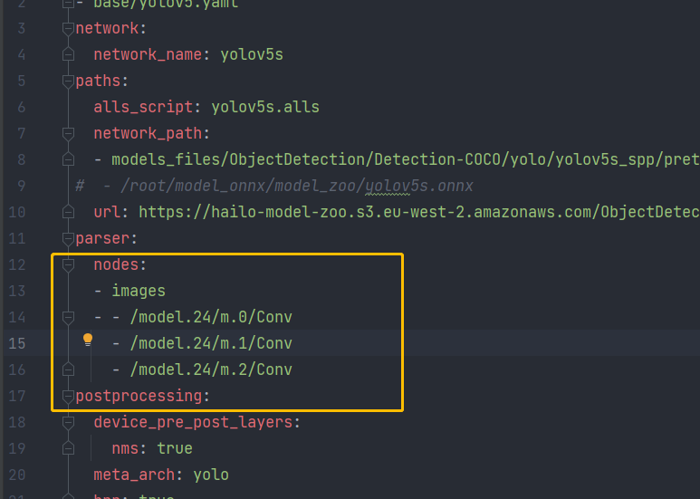

Please make sure that the 3 last Conv names are as written in the netowrk yaml
Is it necessary to write all the names pointed to by the arrows in the YAML file? Change from the first image below to the second image.
yes, these are the nodes that the tool looks for

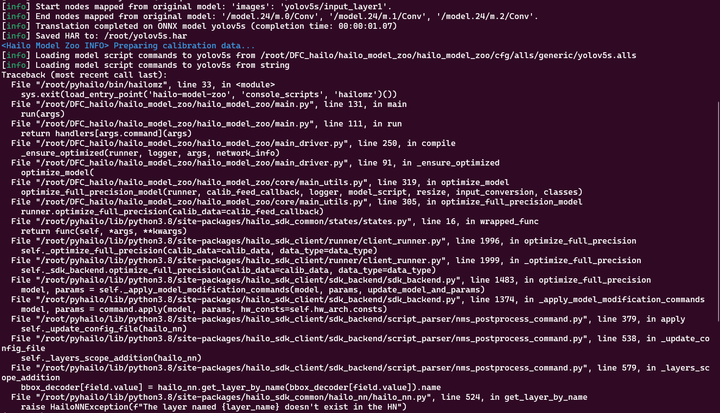

Then he made a new mistake For Hailo Software - #15 by KNN2157

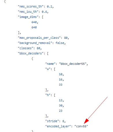

Ok, so you’ve made progress! you’ve passed the parsing stage. Now, before the optimization the tool wants to stitch the NMS on the end layers, but amybe the names were changed. One way of checking the names is with hailo visualizer <MY FILE>.har
See what are the names, and put it in the NMS Json config:
This is taken from this file:
hailo_model_zoo/hailo_model_zoo/cfg/postprocess_config/yolov5s_nms_config.json at master · hailo-ai/hailo_model_zoo (github.com)
Thanks a lot .it’s look like worked.

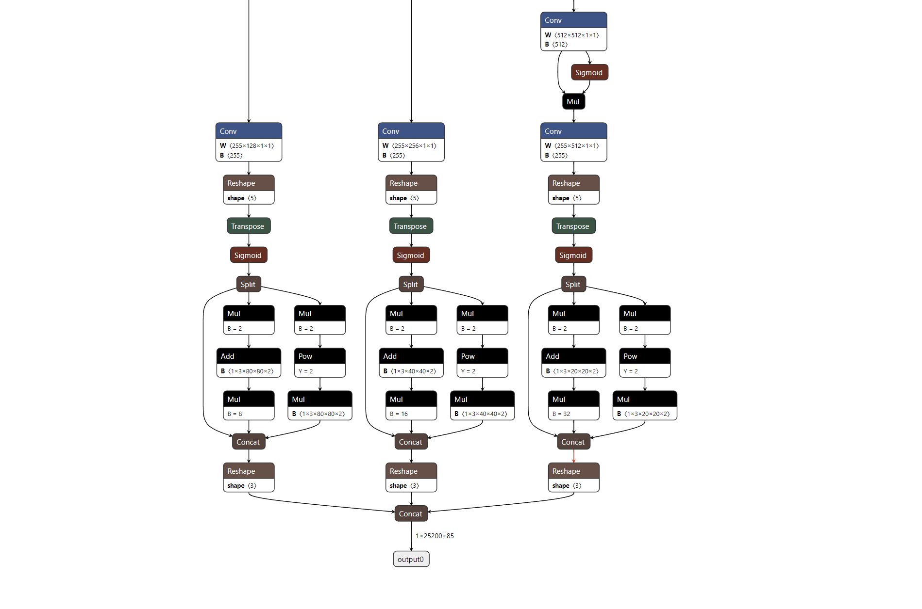

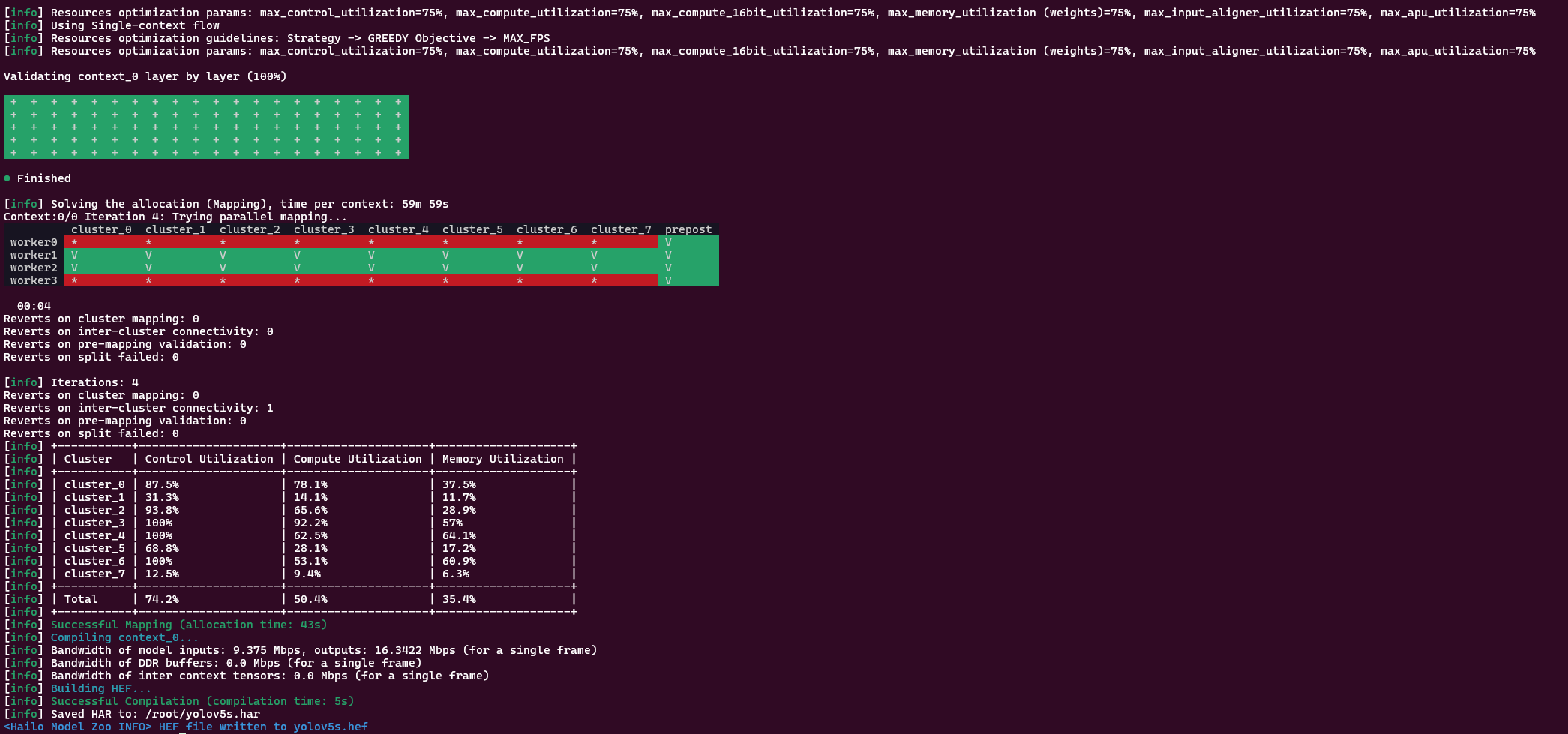

This is the picture. There shouldn’t be any problem, right?
BTW,Where should I find DFC version 3.27,because i have seen other posts suggesting this is an issue of incompatibility between Firmware Version: 4.17.0 (release, app, extended context switch buffer) and DFC version 3.28.
But,the offical web currently only has version 3.28.
This looks ok, the compilation is successfull
