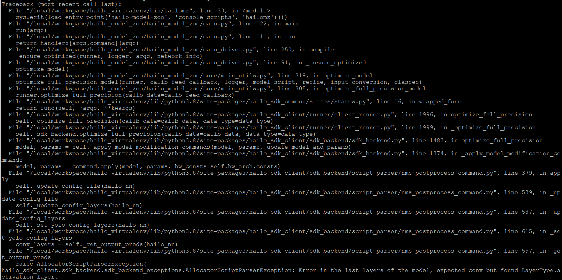

Hi Everyone,
I installed Hailo SW suite in my linux box,
When I’m trying to convert onnx file to hef, I’m getting error.
Command I tried to execute : hailomz compile --ckpt /local/workspace/chip_v2.onnx --calib-path /local/workspace/images/ --yaml /local/workspace/hailo_model_zoo/hailo_model_zoo/cfg/networks/yolov8n.yaml --start-node-names images --end-node-names /model.22/Sigmoid /model.22/dfl/Reshape_1 --classes 80
Error I got :
Please help me here
Thanks in advance
According to your error message, I believe it’s related to the last convolutional layer. Ensure that the convolution names in your YAML file are consistent with the network.
