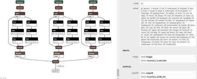

Hi @omria,
Thank you for your response!
  1. I have attached a screenshot of my ONNX file below and tried putting ‘output0’ as the end node, however it does not work. Am I wrongly identifying the end nodes?

Hi @limzhiyong2002
It seems you are encountering several issues with retraining and deploying your YOLOv5 model on Hailo8L. Let’s go through the potential solutions step-by-step:
1. MisspellNodeError: Unable to Find End Node Names
This error occurs when the end node names in your ONNX model do not match what the Hailo SDK expects.
Solution:
  • Use Netron (https://netron.app) to inspect the structure of your ONNX model.
  • From the screenshot you shared, it looks like the final output node is labeled output0. Try using this node name in your YAML configuration.
Here’s the updated YAML configuration:
start_node_names:
  - 'images'
end_node_names:
  - 'output0'
If there are additional output nodes, identify them using Netron and update the YAML accordingly.
