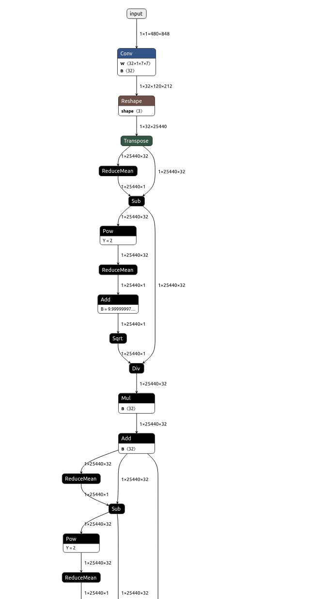

Could you open the model with netron.app and share a screenshot of the model’s input layer?
Did you re-train the model? What’s the reason for only one channel?
of course this is not your model. this is a model trained on our data. it accepts only one channel. assume inputs are infra red images.
